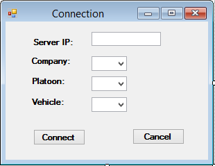

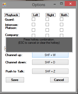

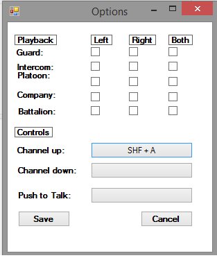

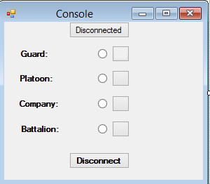

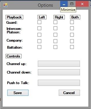

PROGRESS REPORT
I have designed the user interface, which has a splash screen with options and connect.
The options allow you to set your hotkeys for channel up, down and push to talk as well as which ear you want each channel to come out of.
The connection screen asks you for the ts ip address and your vehicle, platoon and company with a connect button.
This then puts you into a console which reacts to your channel up/down and PTT hotkeys.
In terms of coding I have got as far as registering the hotkeys with windows, but am having issues with the PTT differentiating between a keydown and keyup event, as of course I cannot debug because you use the keyboard to step the code!  Issues with working at a low level of the OS!
I have set up a TS server on a work Virtual Machine, so I have a TS environment I totally control.
I have reviewed the documentation for the TS plugin SDK, but have yet to write anything with it.
The basic architecture in my mind is as follows:
When you connect it will either join you to or create a company/platoon/vehicle channel where the channel is the vehicle so that you can use voice activation for the intercom.  As people connect or change their vehicle/platoon/company settings this will throw events which will create dynamic whisper lists, which is what the PTT will address depending on which channel you have selected.  All the clever stuff will be in creating and synching the whisper lists while using TS as the database.  I may run a database server to keep control of the logic and only change whisper lists from there, but that would mean that there would have to be both a client and a server application, so I would rather not.
The Aries Radio (DCS) guy is nice and helpful and the Task Force Radio guy (Arma) is Russian and less so, but I think his product is better.  Nonetheless the fact that they have done all I want to do and much more shows that it can be done with the SDK: just a matter of time and application.
Coding volunteers with Visual Studio 2013 and C# experience welcome!!  C++ would be a real help as that's what the SDK and example application are written in.

Very interesting project.  Two suggestions:
(1)  The "Both" checkbox column is superfluous.  If someone wants the audio in both earpieces, they can just check "Left" and "Right."

The both point is well made.

I am getting close to releasing the user interface as an alpha product.
At present as hotkeys it takes 1*modifier + 1*key or 1*key. (Modifier = SHIFT, CTRL, ALT, WIN).
Given that Sb grabs the whole keyboard it will take a modifier.
My question is, do I need to add the dx dll that allows joystick buttons to be recognized, or do we all do what I do, which is code our joysticks with TARGET GUI or similar, such that our joysticks are just replicating complicated keystrokes?
