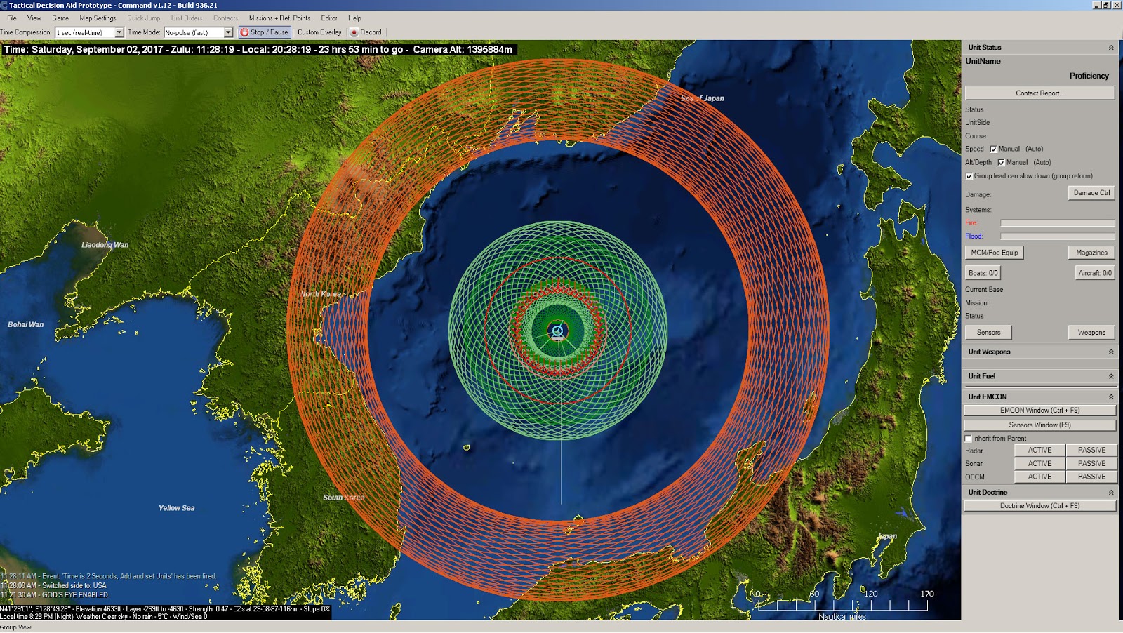

Addressing such a situation with a CMANO scenario is easy because the initial positions for both the ship and the sub are known beforehand. Alas, the commander rarely knows the position of an enemy submarine. In this blog entry I want to share the results of a tactical aid I generated for a virtual US ship commander that is in a hurry to sail south. He wants to know what are the likely submarine initial positions from which he can be detected.

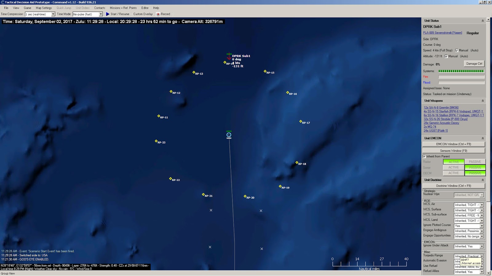

The setup. A US Ticonderoga-class guided missile cruiser (blue icon) is navigating sout at flank speed. Unknown to his commander, a DPRK submarine (a SSN of the Severodvinsk-class, yeah I know I am not Tom Clancy) can be anywhere 50 nm from him and will start patrolling the circular area highlighted with the yellow reference points.
In the screenshot above, the start of the scenario is shown, with the US warship in the center and an enemy submarine, 50 miles away, which can be seen because I'm using God's eye view.

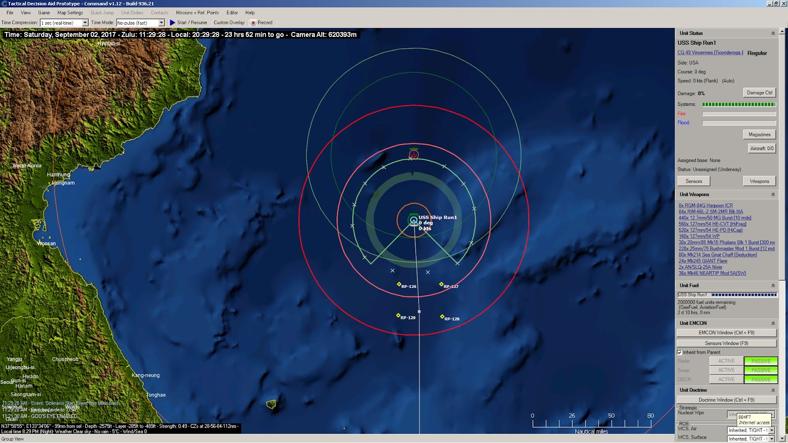

A typical scenario start. The ship and sub placed, just waiting for me to start the thing by clicking the Start/Resume button.
