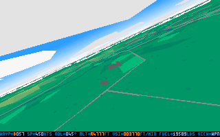

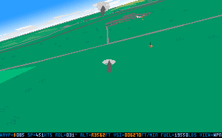

Hi Tom
Looks like an unfinished runaway! LOL.
Please check if your file C:\TORNADO\TORNADO\AMP\MAP3\TREE3.BIN is the original TREE3.BIN, or if it is the modded TREE3.BIN from the http://dogsofwarvu.com/forum/index.php/topic,5046.msg29189.html#msg29189 post.
If your TREE3.BIN is from that post, then see if you can remove it by overwriting it with the original C:\TORNADO\TORNADO\AMP\MAP3\TREE3.BIN.
I am trying to see if this is the cause of the strange artifact or it is caused by something else.
Oh yes, I just realised that this file was also modified (as part of the tree mod):
C:\TORNADO\VISUAL\MAP\SECTORS\OBSECDEF.INC
That OBSECDEF.INC file is itself used by C:\TORNADO\VISUAL\SECDATA1.ASM.
So what I have just done is to restore the original 1993 C:\TORNADO\VISUAL\MAP\SECTORS\OBSECDEF.INC and I have recompiled C:\TORNADO\VISUAL\SECDATA1.OBJ and relinked the entire FLIGHT.EXE.
UPDATE - 22 June 2018, 12:50am Kuala Lumpur time
And there's more! These 4 files were also modified as part of the tree mod!
C:\TORNADO\VISUAL\OBJECTS\GROUND\COPSEA.INC
C:\TORNADO\VISUAL\OBJECTS\GROUND\COPSEB.INC
C:\TORNADO\VISUAL\OBJECTS\GROUND\COPSEC.INC
C:\TORNADO\VISUAL\OBJECTS\GROUND\COPSED.INC
A 'copse' is a cluster of trees. So these four files have something to do with the tree patterns and density.
All four INC files above are used by C:\TORNADO\VISUAL\GRNDOBJ1.ASM.
So I have just restored the original COPSEA.INC, COPSEB.INC, COPSEC.INC and COPSED.INC files, recompiled C:\TORNADO\VISUAL\GRNDOBJ1.OBJ and RE-linked the excutable FLIGHT.EXE.
Try RE-downloading the attached latest FLIGHT.EXE (that doesn't have the tree mod) and see if that offending and deceptive artifact is still there.

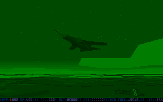

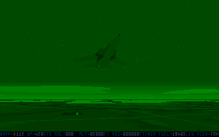

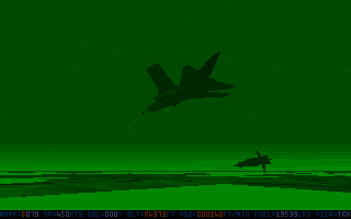

73. Improved stars and Tornado colors for Night Vision Goggles (NVG) mode
Mod: Better environment colours for the NVG mode
By Frankie
Description: Night Vision effect was first tackled on this forum here.
Without Night Vision. When playing night mission, unless you have a high-quality monitor
(e.g., a IBM/lenovo monitor), the Night Vision (Shift+Tab) is a MUST.

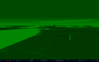

However there were two deficiencies which spoiled the effect. Firstly, when the IR Night Vision was turned on, you would see black (dark) stars.
Black stars in the sky and FLIR display? Spoils the NVG effect.
Black stars? 'Invisible' panels make the Tornado difficult to see, spoiling the game.

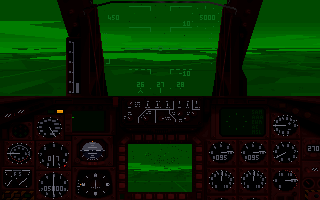

Secondly, parts of the Tornado became invisible because of poor contrast between the components (fuselage, wing, etc,) and the surrounding environment (ground and sky).

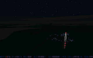

I have now discovered how to improve the Night Vision colors of the stars and the Tornado. The trick is to modify the

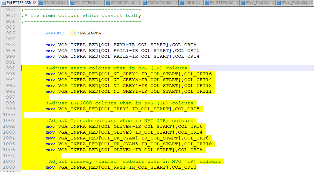

C:\TORNADO\VISUAL\PALETTES.ASM
Ground Zero of the code to adjust the colors which by default turn out badly in Night Vision colours
Below is the result.
Stars show up as bright dots; Tornado is better contrasted against its surroundings.
Related files:
C:\TORNADO\VISUAL\STARS.ASM
C:\TORNADO\VISUAL\STARDATA.INC
C:\TORNADO\VISUAL\PALETTES.INC
C:\TORNADO\VISUAL\TORNADO1.INC
Attached is the FLIGHT.EXE.
Better NVG visuals now
Note: I have removed the trees mod from this FLIGHT.EXE as the trees were out of control, sprouting in the middle of roads. Perhaps it is for the best and I expect to see some better frame rates with less objects to render.
Update on 22/6/2018. Adjusted the LGB1000 color when in Infra-Red (NVG) mode. Previously the LGB1000 was invisible when switching to V view in NVG mode. Code snippet in PALETTES.ASM now looks like this:
      ;Adjust LGB1000 colours when in NVG (IR) colours
      mov VGA_INFRA_RED[COL_GREY4-IR_COL_START],COL_CRT5
LGB100 is now visible when in NVG mode!
Cheers.

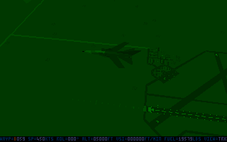

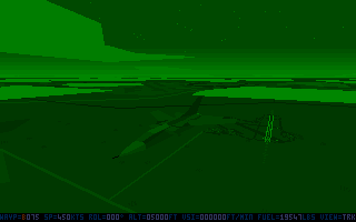

Tornado is highly visible when on the tarmac. I had to darken the tarmac otherwise the Tornado would disappear into it!
Modded code after all the colour adjustments.

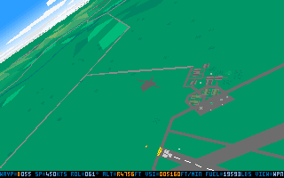

74. Enhanced Explore feature
Mod: Improved usability of Explore
By Frankie
Description: Modded version of Explore feature in Digital Integration's Explore feature.
Here's what's new:
1. Pitch ground down (key 1) and up (key 0)
2. Swivel left (key z) and right (key x)
3. Now default mode is keyboard control
4. Default starting view height is 1000ft for a more panaromic view
5. Improved bottom status bar with help keys
6. Reversed the actions of UpArrow and DwnArrow keys so that, NOW, UpArrow raises elevation and DwnArrow lowers elevation.
Summary: better pre-mission planning and target ID/visualisation.
Attached is the latest FLIGHT.EXE.

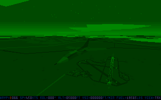

Since Tornado has many night missions, I thought that it would be useful to see the external view in green infra red colours. Hit Shift+Tab to toggle between daytime and green infra red colours.
I have reuploaded the FLIGHT.EXE file. Enjoy.

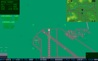

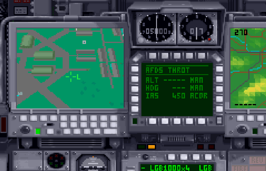

76. Shift+D in Navigator's Cockpit will activate the full-screen FLIR and TIALD
Mod: An immediate way of going full-screen FLIR/TIALD when in Navigator's Cockpit
By Frankie
Description: Shift+D now activates the full-screen FLIR and TIALD views when in the Navigator cockpit view (PgUp).
Three months ago, I wrote Mod#50 (10th Apr 2018), which allowed the gamer to instantly access the Full-screen FLIR view when in the Pilot's Cockpit view (Home). Yesterday I was thinking that it should be possible to code NAVIGPAN.ASM so that the same can be done by the gamer when in the Navigator's view. It was harder than I thought, but in the end I managed to 'tame' the code. I also needed to handle the case where either TV-Tab was damaged. That upon exiting the full-screen FLIR/TIALD, I needed to restore the TV-Tab view properly. I decided to exit the view and just show the standard TV_Tab sized TIALD display. I also needed to restore the previous MFD view (it could be any of the following MFD modes: MFD_MAP, MFD_RADAR, MFD_AUTO_PILOT, MFD_ILS, MFD_FLIR_ORI and MFD_FLIR).
Use case flow:
1. Gamer hits PgUp to go to the Navigator's Cockpit
2. Gamer hits Shift+D, the full-screen FLIR view appears
3. Gamer hits Shift+D again, the full-screen TIALD view appears
4. Gamer hits Shift+D again, the Navigator's Cockpit comes into view again. The MFD display in the centre retains its last cycled view (Key D), whilst the left TV-Tab will show the TIALD view, albeit in the standard TV-Tab sized view.
Previously one had to cycle through the "[" or "]" keys to do this. Now you can bypass these steps with the Shift+D shortcut. A second Shift+D will bring the gamer back to the Navigator's Cockpit with the left TV-Tab showing the standard small-screen TV_Tab-sized TIALD view. The code is clever enough to handle the case where if either left or right TV-Tab is damaged, the full-screen FLIR/TIALD will appear on the remaining TV-Tab.

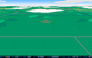

79.  Spectator View (F4) can now be pitched up and down
Mod: Pitch-variable Spectator View
By Frankie
Description: The Spectator View has always been pannable left-to-right via the Z and X keys. Now I have added a "press 1 pitch up and 0 to pitch down" feature. Therefore immediately after pressing F4 to go into the Spectator View, you can adjust the horizon vertically (newly added) and swivel horizontally (exists in stock Tornado).
Tornado is  retreating into the distance after F4 is pressed.
Horizon can be raised (Key 1) and lowered (Key 0)
This is a trivial feature which allows for more screenshot (Ctrl+F5) artistic angles. One more to hit 80 hacks/mods.
Attached the FLIGHT.EXE as usual.

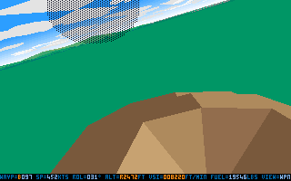

80.  Weapons View (V) roll can now be angled
Mod: Weapons View with roll angle
By Frankie
Description: If you bank your plane and let loose an ordnance, the ordnance (LGB1000, RET1000, etc.) will be displayed at a tilt of the curent roll angle of your Tornado. Hit Alt+P to toggle the tilt on and off. Makes for interesting screenshots of the ordnance against a tilted background.
Laser Guided Bomb on its way down. Nice view. Never before seen angle.
retarded bombs on their way down. Never before seen angle.
Another view of the same retarded bombs on their way down.  Nice view.
Why is this crater angled? Just hit Alt+P if you want to display the background level.
