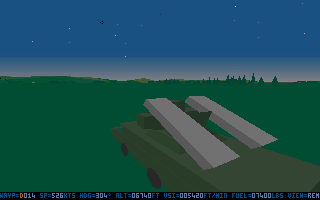

63. SAM Launcher-to-Tornado View activates with F11
Mod: SAM Launcher-to-Tornado View
By Frankie
Description: In the stock Tornado, you almost never see the ZRK "ROMB" SA-8 SAM launcher. With this mod, you can now get up close and personal with this Soviet amphibious vehicle. In the heat of battle, when you are getting locked on and suddenly find SAMs being shot at you, hit the F11 key and you will see a SAM launcher in the vicinity. And the best part is that it is facing you and shooting up Gopher missiles at you! Here's are some actual screenshots:
-AND-
-AND-
This view will have a viewpoint slightly away from the ZRK "ROMB" SA-8 that is firing at you. The view will track your Tornado, but the SAM launcher will not always be in view. This is a Frankie Kam innovation but it is still experimental. As such, you may have some weird results.
-AND-
Nevertheless, this is the first time that a reversed view (i.e., Enemy to Tornado view) has been implemented. So enjoy.
Frankie Kam

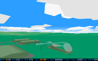

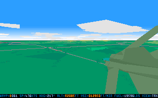

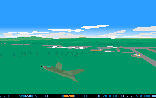

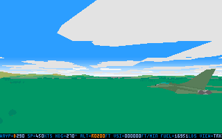

#91

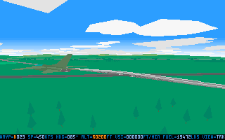

64. You can slew the viewpoint left-to-right in Tracking View (F1) - applies also to Drone in Drone View (F5).
Mod: Slew the viewpoint left of or right of the Tornado on the horizontal axis
By Frankie
Description: Enabled slewing left-right of Tornado and Drones with the "2" and "9" keys. Now you can move the perspective/viewpoint of the Tornado along 3 axis'. This is different from the "Z" and "X" keys which rotate left or right by pivoting on the Tornado. This mod allows you to adjust or shift the viewpoint to the left or right of the Tornado. The video below will make it clearer what this mod does.
No sound.
The main use of this mod is to enhance the Tracking (F1) and Drone (F5) views. The keys "2" and "9" used with the other external view adjustor keys "1","0","F1","F12", now afford you with an almost infinite number of  combinations of angles to display the Tornado and drones for artistic and for aesthetic purposes.
-AND-
-AND-
-AND-
-AND-
-AND-
You can enjoy both views more and gives more opportunity for nice screenshots. The Drone view used to be mundane after a while. No longer. This is new to the simulation. Another innovation.
Frankie Kam

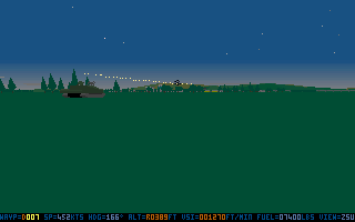

65. AAA-(Shilka)-to-Tornado View activates with F12
Mod: AAA-to-Tornado View
By Frankie

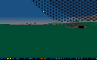

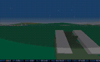

Description: In the stock Tornado, you also almost never see the ZSU-23-4 Shilka AAA vehicle. With this mod, you can now see this famous AAA weapon in action. In the heat of battle, when you are getting locked on and suddenly find high-velocity tracer being shot at you, hit the F12 key and you will see a ZSU-23-4 in the vicinity. Most probably launching radar-guided cannon shells at your Tornado. Specifically, this mod gives you a view unlike any other in stock Tornado - a tracking view from a spot near the Shilka, to your Tornado.

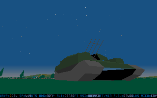

-AND-
A bit of dilemma with the distance of the viewer from the Shilka. Too near and you never see the vehicle in its full glory. Too far and the Shilka looks too small. I am still tweaking the distance values, so I have yet to hit the sweet spot.
Here are ALSO two Youtube videos showing the action. Enjoy!
-AND-
-AND-
This is 1993 graphics. So expect some anomalies. For example, in the videos above, the Shilka's turret does not rotate. Instead the entire Shilka itself will in seconds magically re-position to face the Tornado. Su-27 Flanker 1.5 by Flying Legends (published by SSI), did the animation very nicely with rotating turrets and highly detailed Soviet armored vehicles. But that was in 1995 and a whole different simulation. Digital Integration's Tornado graphics were designed in 1991 and by the time the game was released, the graphics engine was two years out-of-date!
As usual, I am attaching the latest FLIGHT.EXE file. Press F11 to see the ZRK-ROMB (SAM launcher) in action. Press F12 to see the Shilka AAA in action. This is still pretty much proof of concept. So you will hear lots of cannon fire and SAM launch sounds - even when in the cockpit. No time to tidy it all up. Main thing is, this is making DI Tornado simulation history with never before seen views. It is exciting to be able to create a view never implemented before in Tornado. Welcome to 2018!
Frankie Kam

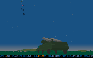

Mod: Shilka and Gecko View
By Frankie
Description: The 1993 Tornado simulator was always about the Panavia Tornado. Now in 2018, with this mod, you will come face-to-face with two dreaded anti-aircraft Soviet weapons. This mod adds the ground anti-aircraft element to the game, bringing Digital Integration's Tornado into a new Quantum of gameplay.
If you have ever played Tornado, you will know that the AAA and SAM launchers are always a speck on the ground. Even if you did see one up close, it was only for a micro-second using the Weapons (ALARM) view where the enemy appears for a brief split-second before being reduced to toast. Well with my new mod, it is time that we give these two dread and highly respected weapons their due.
You can now see them up close in real-time. Watch them fire cannon shells and SA-8 missiles at your Tornado as you make your bomb run. You can even, if you are lucky, see your missile strike home and reduce them to a crater. These views are what Tornado badly needs. An ode and a shout-out to the ground enemy vehicles which were always there in the simulator, but you could barely see them or touch them. Now you can see them up close in action firing away at your Tornado, from any angle or elevation with this mod.
The ZSU-23-4 Shilka is a 23mm self-propelled anti-aircraft gun.
The 9K33 Osa (English: wasp) is a highly mobile, low-altitude, short-range tactical surface-to-air missile system designed in the Soviet Union. "9K33" is its GRAU designation. Its NATO reporting name is SA-8 Gecko. Its export version name is Romb.
Here they are with their own new views. Activate by pressing
Shift+Ctrl, followed by Alt+Shift
-OR-
Ctrl+Alt, followed by Alt+Shift
If after you press Shift+Ctrl or Ctrl+Alt and you do not see any SAM launcher of AAA vehicle, wait until the enemy has you in its radar and you start seeing tracer fill the sky or you start hearing SAM launch sounds. Then hit the Alt+Shift key for a surprise!
View control keys coded specially for this mod:
1. Press and hold Shift+Ctrl see the vehicle from a higher angle (e.g. imagine being higher than the vehicle, looking downwards);
2. Press and hold Shift+Alt see the vehicle from a lower angle (e.g. imagine lying on the grass and you are looking up towards);
3. Key "1" to shift the horizon down so that more sky is seen;
4. Key "0" to shift the horizon up so that more ground is seen;
5. Key "2" to shift the view point right-wards, perspective of vehicle shifts leftwards
6. Key "9" to shift the view point right-wards, perspective of vehicle shifts leftwards
Caveat: if you zoom in or zoom out and if you use the Z and X keys to rotate the vehicle, your Tornado in the F1 Tracking View will also zoomed and rotated accordingly. I haven't figured out how to decouple F1 view from these two new views when it comes to the zooming and rotating actions.

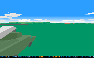

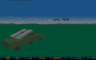

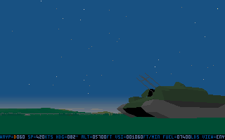

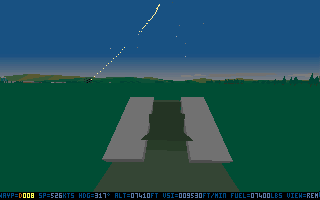

Some screenshots below. In 1991-1994, this was 'cutting edge'. Seeing them so up close, at last, is amazing, for me at least.
-and-
-and-
-and-
These two new views are similar to F11 (Hack#63) and F12 (Hack#65), yet so different. The F11 and F12 screens are tracking screens, meaning that they will follow the Tornado from the ZSU or ZRK's point of view, but those screens cannot be rotated, height-adjusted or changed. Hack#66 is all about showing off the ZSU or ZRK in al their glory, with pannable and height-adjustable viewings.
Here is a Youtube video showing you what these two new views are all about.
In the video, my Tornado is that black speck in the sky letting off flares. The SAM launcher and AAA are taking pot shots at me. The views you see in the video were not possible for 25 years. Now it is possible, thanks to the wonderful, extensible code of the 3D engine written by Kevin J. Bezant. There are many other modding possibilities, limited only by the imagination. As usual, I attach the latest mod-cumulative FLIGHT.EXE below. Enjoy.
Frankie Kam

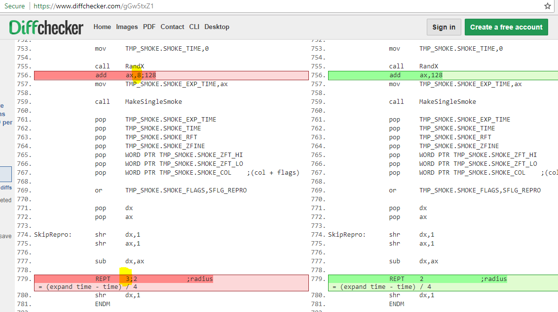

67. Smaller smoke graphics
Mod: Smoke graphics and animation are now smaller in radius and shorter in lifetime duration.
By Frankie
Description: Tornado simulates smoke by drawing black circles. The circles last N seconds in duration and are modeled to me N feet in radius. In Mod#65 and Mod#63, I discovered that the ZRK-Zomb and ZSU-23-4 Shilka were always shrouded in enormous clouds of black smoke when either firing 23mm cannon shells or launching SA-8 missiles. The smoke circles were insanely large, and immensely disproportionate to the Soviet antiaircraft vehicle.What I did then was to find out how to make the smoke circles smaller. A quick check on Youtube showed me that as a ZSU-23-4 fires into the air, it does make puffs of gray smoke in front of the cannon muzzles, but definitely not large, billowing plumes of black smoke.
So this mod is all about making the smoke circles smaller and more realistic dimensions.
Mod#67 basically has already been done as it is part of Mod#66. Nevertheless, I want to share with you what I did to make the smoke graphics in Mod#66 smaller and more realistic. This link https://www.diffchecker.com/gGw5txZ1 is the diffchecker link to a comparison between my modded \VISUAL\SMOKE.ASM and the stock original \VISUAL\SMOKE.ASM file. Below are the salient points of the mod.
ASSEMBLY LANGUAGE 101
Basically, I reduced the smoke expiry time from the value 128 to 8 (see line 756). This means that the smoke circles for not linger for long.
I also reduced the radius of the smoke circles by increasing the divisor in the formula "radius = (expand time - time) / 4". I did this by changing
REPT   2
  shr   dx,1
ENDM
;The operation shr means "Shift Right". This shifts each bit of register dx, one place to the right.
;So shr dx, 1 means divide the value inside dx by 2. If we REPT (repeat) this 2 times, the original code
;is basically dividing the value of dx by 4.
to
REPT   3           ;So by changing the repeat value from 2 to 3, I am actually shifting the bits of the register
  shr   dx,1       ;three places to the right. In effect I am now dividing the contents of dx by 8!
ENDM             ;So since the divisor is now larger (8) compared to previously (4), the smoke radius will be smaller.
I.e., "radius = (expand time - time) / 8" is smaller than "radius = (expand time - time) / 4".
So I do this for various parts of the code inside \VISUAL\SMOKE.ASM. See the attached file if you are up to peeking at the assembly language code.
Frankie Kam
