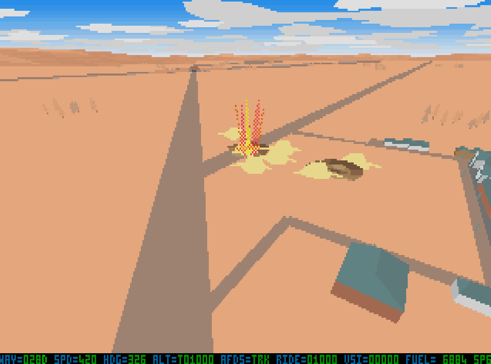

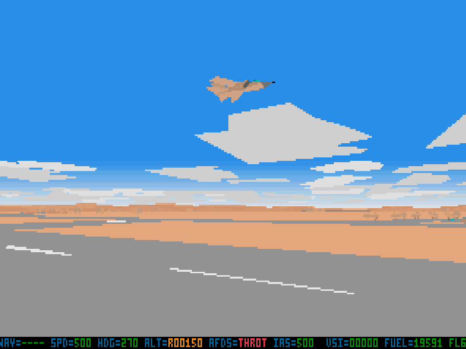

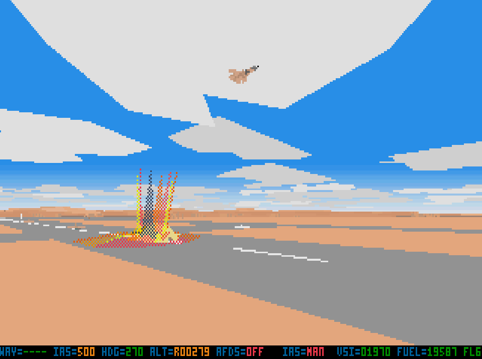

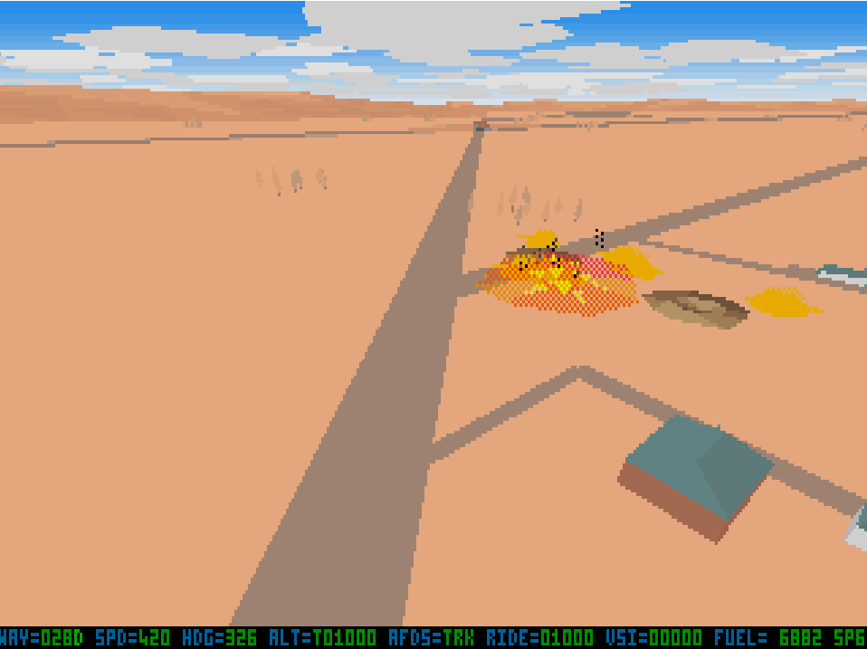

191 & 192. Improved Flyby (F3 key) and Weapons views (V key)
Mod#191 - Improved Flyby View with emphasis on ground action (F3 key)
I thought I'd spice up the already modded flyby view by adding a low-level action element. When the Tornado is flying 800 feet or below, and the gamer hits the F3 (Remote view key), the Tornado is viewed flying by from the ground level, looking up. In my humble opinion, this makes for a slightly more dramatic flyby (read: less boring) view.
Low-flying Tornados will be viewed from the ground when the Flyby View (F3) is hit.
Another view from the ground when viewing the external Tornado in Flyby (F3) mode.
Mod#192 - Improved Weapons View (V key)
In the current modded Weapons View, the weapon will fly all the way to the target, usually situated at ground level, and explode right at the target. The screen will be filled up mostly with the crater. In mod 192, I stopped the camera view a few seconds before impact. So the final moments of the explosion are shown together with more of the surrounding area of the target.
GPB1000 hitting its target
Aftermath of the explosion.
Attached is the Desert Storm version of the latest FLIGHT.EXE file.
Cheers
Frankie Kam
« Last Edit: April 19, 2025, 05:14:20 PM by Frankie »

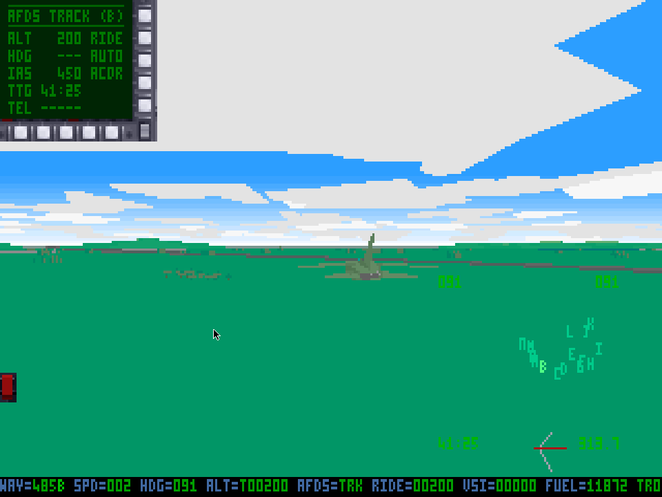

  • Moderator
Re: Modding Tornado
« Reply #395 on: June 17, 2021, 12:36:27 PM »

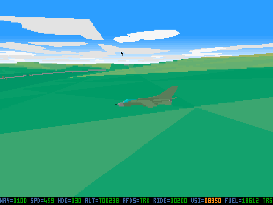

193. Automatic Fly-by (F3) view
Now when you hit F3, it will display a fly-by view after every 9 seconds. Hands free. Meaning that you need not hit F1 or F3 again after the initial F3 keystroke.
The animated gif above starts with the F1 Tracking view. Impressive initial view, huh? Would look nicer with a Tornado shadow!
Then I hit the F3 key and I leave it as it is, interspersed with the occasional F3 keystroke.
If you do not hit the F3 key again, the next fly-by view will be with the Tornado flying away from you. If after the initial F3 keystroke, you hit the F3 key, the Tornado will be flying *towards* you, before flying past you and receding away into the horizon.
WHAT THIS MOD DOES VISUALLY,
1. Hit F3 (Remote View, a.k.a., the modded to Flyby view)
2. Wait 9 seconds
3. The Tornado will again do a flyby, but it will briefly approach from a side angle, before disaapearing into the distance
4. Step#3 repeats itself again and again unless you intervene with a F1 (Tracking View) or some other view like V (Weapons view) or F4 Spectator view.
FOR "BEST" FLY-BY VISUAL RESULTS,
2. Wait 6 to 7 seconds
3. Hit F3 again manually and the Tornado will be approaching you, before flying past you as a flyby view
Cheers
Frankie Kam
« Last Edit: October 03, 2024, 12:33:26 PM by Frankie »

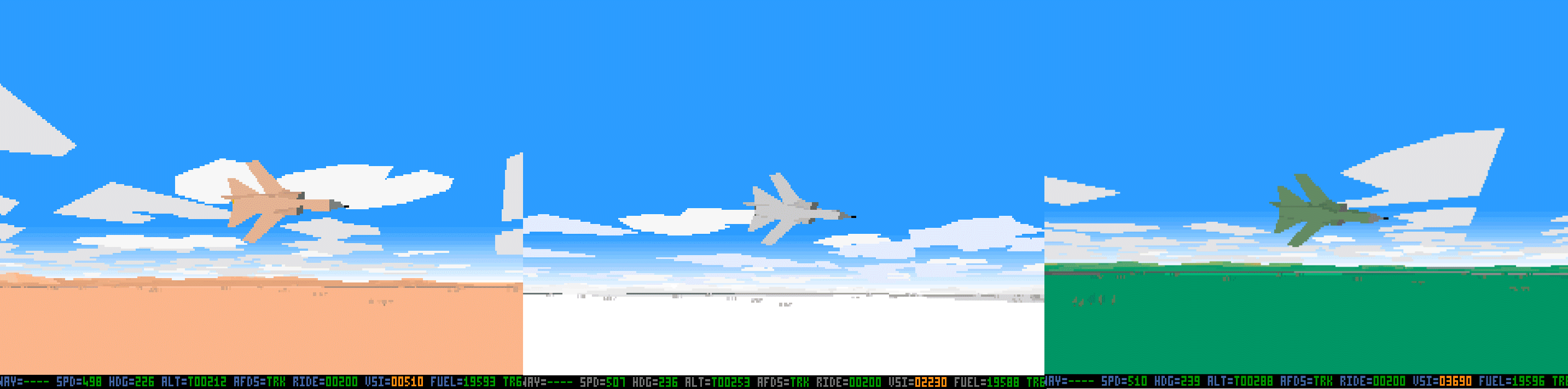

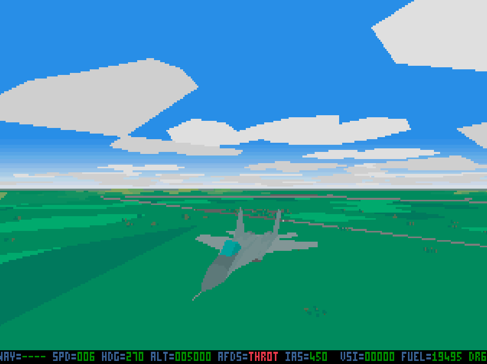

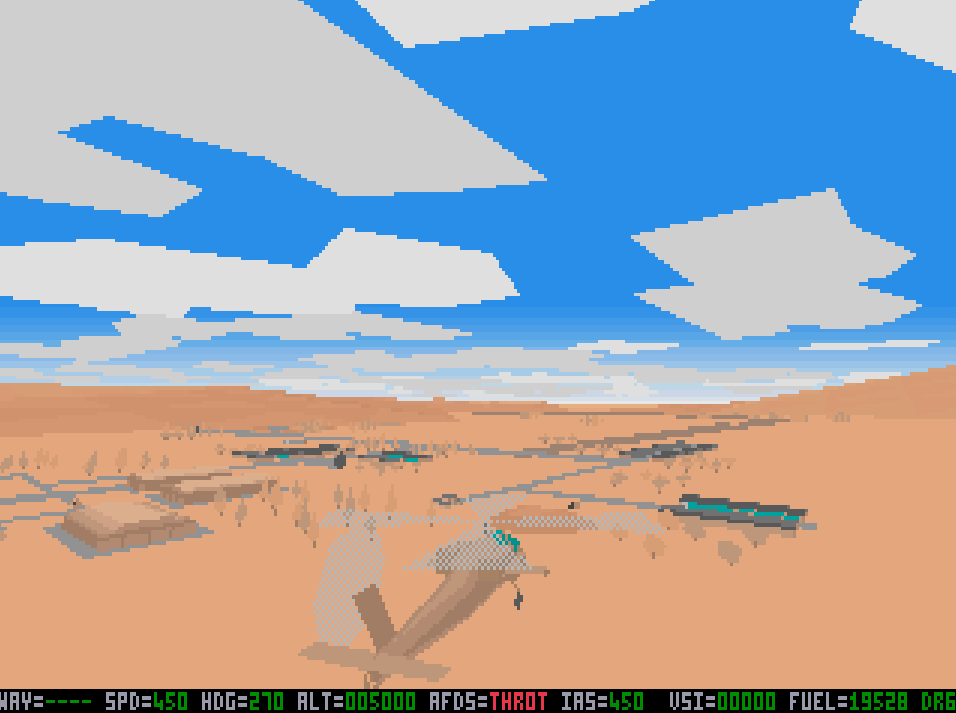

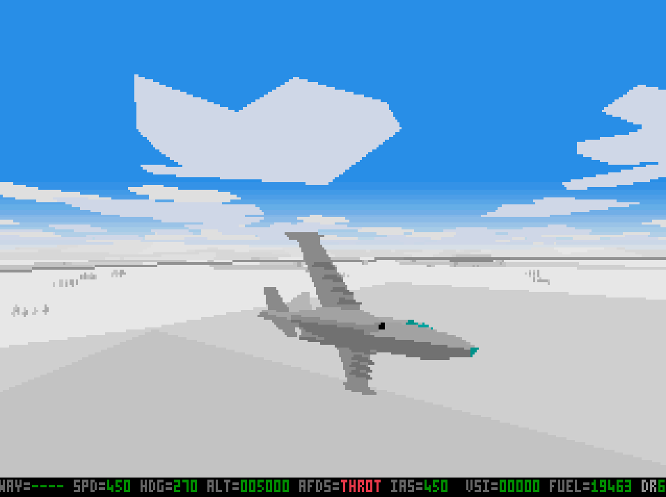

194 & 195. Automatic Spectator View (F4) view and Cyclic Drone View (F5)
I extended mod 193 to other areas of the 3D simulation engine.
Hit F4 and the Tornado will be shown in the Spectator View. Tornado flies away into the centre, away from the gamer, as an ever diminishing shape. Wait for 6 seconds and the view will repeat itself. There is no need to hit the F4 key. These features apply to all drone aircraft and ground mobile objects as well.
Mig-29 in European colours
Hit F5 and the current Drone (Tornado, F15, F16 etc.) will be shown in the Drone View. Wait for 12 seconds and the view will cycle to the next available Drone. I created this cyclic view because I had, in the modding process much earlier, removed the Drone Demo code.
Boeing AH-64 Apache in Desert colours
In the original FLIGHT.EXE, if you executed a FLIGHT /d1 command at the DOS or DOSBox command prompt, the Drone demo mode would kick in. So I decided to add this feature back into modded FLIGHT.EXE. So to speak.
Sukhoi Su-25 in winter colours
Attached is the latest FLIGHT.EXE in three flavours, packed inside the "FLIGHT_Europe_Desert_Winter_EXE.zip" file.
1. FLIGHTE.EXE = European (game's default) colours
2. FLIGHTD.EXE = Desert colours
3. FLIGHTW.EXE = Winter colours
Rename to FLIGHT.EXE and add to taste. And a very Happy Father's Day to all!
Frankie Kam
« Last Edit: April 19, 2025, 05:35:53 PM by Frankie »

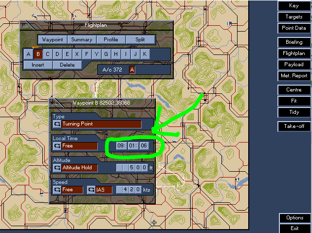

196. Minimalist clock
The skeleton clock in daylight colours
I added a minimalist clock display below the skeleton route plan display. Hit F1 for the tracking view, followed by a the "]" (right-square bracket) keys.
The idea came to me when looking at the Advanced Mission Planner. Every waypoint has a real-time mission time deadline. I don't think it is possible to display a waypoint's arrival time one the screen.
The famous and powerful Advanced Mission Planner created by Robin Heydon. Unchanged for nearly thirty years!
However if I could manage to display a waypoint's expected arrival time on the screen, then the clock would show the Tornado gamer how far off or how close to the mark, he is from the actual arrive time.
The clock at night.
Cheers
Frankie Kam
« Last Edit: October 03, 2024, 12:35:00 PM by Frankie »

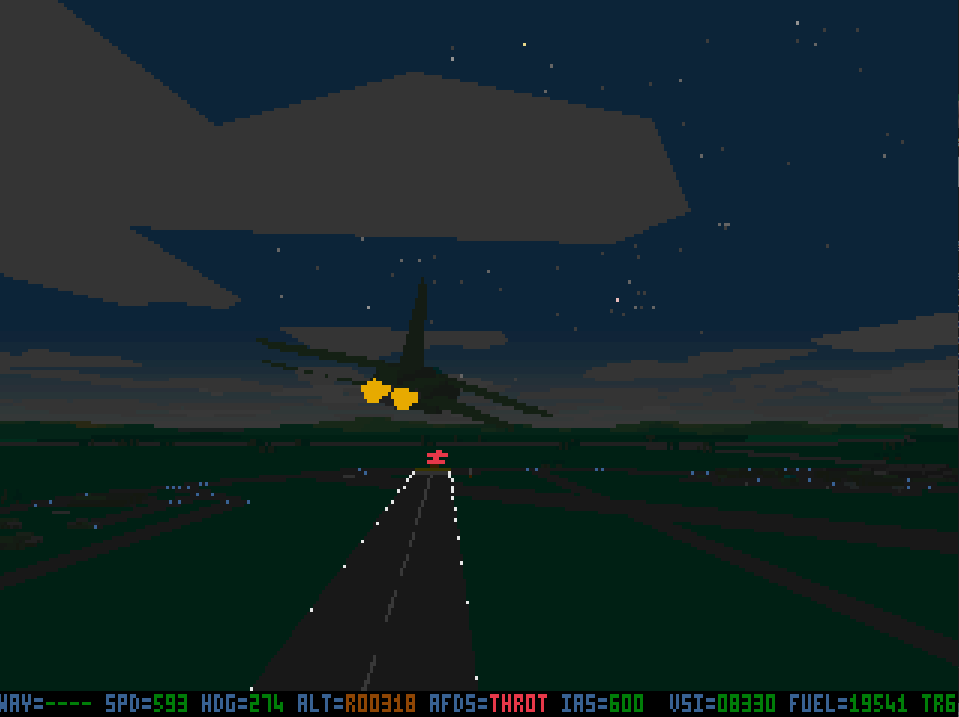

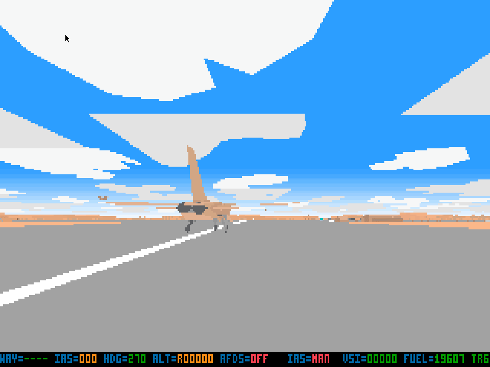

I fixed a minor but annoying bug -  when the Tornado is on the ground, and while in external view (F1), pressing and holding the key "1" will cause a horizon anomaly.
This has now been fixed.
