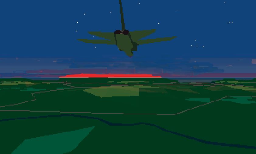

103. Enhanced flyby for tornado with just F3
Mod: Flyby re-engineered with F3 key
By Frankie
Description:  Modded Flyby view (F3 key). Previous mod required you to hit F1 before hitting F3 for a nice flyby view. Now you just need to hit F3 without F1 to get a nice(r) flyby view. When you hit F3, if the flyby is activated (in some cases it won't especially when nearing Target X or Target Y), the view will swivel so that the Tornado is oncoming. Then the view follows the Tornado as it leaves your field of vision.
Some scenes are F1 followed by F3. Most visuals, however, were the result of
just hitting F3 by itself. A Tornado-flyby innovation.
The F3 key works most of the time except for parts of a mission where it becomes a fixed view from some viewpoint way out. I haven't figured out why this is so. Still, there are enough moments in any mission where hitting F3 gives you a nice panaromic view of your Tornado sweeping by.
Frankie Kam
« Last Edit: October 05, 2024, 03:34:00 AM by Frankie »

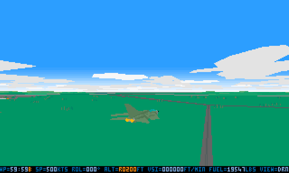

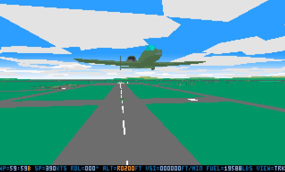

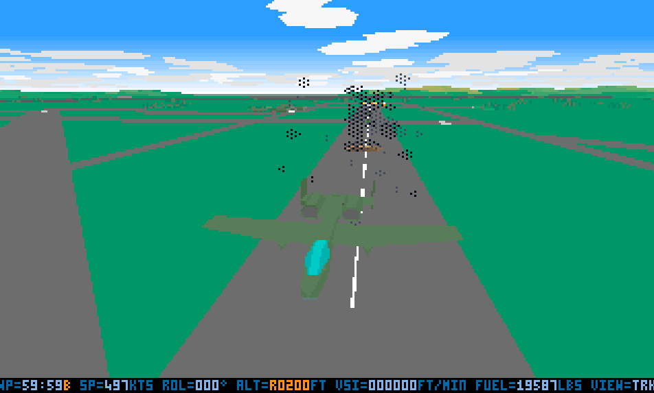

104.  A10 Wannabe
Mod: Trading plane models - Swapping the Tornado 3D model for the A-10 3D model (all other aspects unchanged)
By Frankie
Description: I thought this one out of the blue. What if it were to possible to fly the A-10 in external views instead of the usual Tornado IDS? In otherwords, fly the Tornado as usual, except that the Tornado would assume the 3D model and shape of the A10. And like-wise - to make the A10 assume the 3D model and shape of the IDS Tornado. So I decided to try it out for a lark (just for fun). Guess what? It works. Haha. See image below.
See the bottom status bar "VIEW="? It shows "TRK" which means tracking view.
So this isn't your usual DRONE view, mate!
What I did was simple. I merely swapped the IDS Tornado and A10 3D object model code. Here's what I did exactly which is (Fair)child's play.
Step 1. Open the file \TORNADO\VISUAL\OBJECTS\MOBILE\TORNADO1.INC using a text editor like Notepad++
Step 2. Edit the first word of the first line by changing the word Tornado1 into A10
Step 3. Open the file \TORNADO\VISUAL\OBJECTS\MOBILE\A10.INC
Step 4. Edit the first word of the first line by changing the word A10 into Tornado1
Step 5. Compile the ASM source file \TORNADO\VISUAL\MOBOBJ1.ASM
Step 6. Link all OBJ files by executing the command "link @main.lnk" (without apostrophes) - usually put inside a batch file like L.BAT (on my system)
Step 7. Execute FLIGHT.EXE and vola!
So what does this mean (other than having some mindless fun flying an A-10 which for all practical intents and purposes is still an IDS Tornado)? This means that which some creativity and time on one's hands (not mine!), one can redesign the simulation to be an A10 flight simulator. For that to happen (which won't, but it is still interesting to consider the possibilities), the cockpits have to be redesigned, not to mention the avionics, and everything else. But the development guys over at Falcon BMS 4.XX have already done this kinda thing, so this thought will just remain ... a thought.
Still nothing beats moving mud as a Fairchild Republic A-10 Thunderbolt.
Letting loose a 1,000 pounder at 200 feet is not my idea of fun!
Checking on the A10 drones with F5 (Drone View) and I can see that where it usually shows an A-10 flying lazily slow at low level, I now see an IDS Tornado. So I rest my case.
Split personality planes to confuse the situation. But it's all for science, so it's okay I guess.
Haha.
« Last Edit: October 05, 2024, 03:34:16 AM by Frankie »

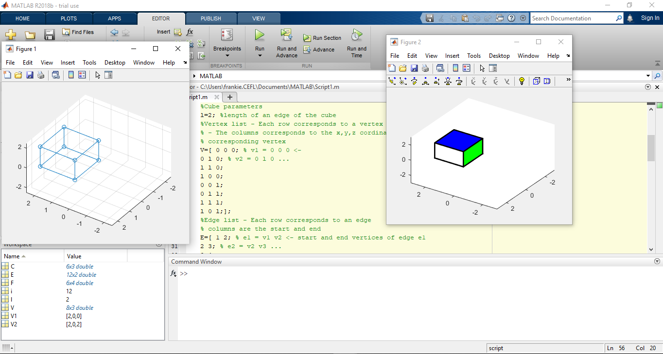

Update on my modelling Tornado sub-project. 4th December 2018.
I downloaded and installed a trial version of Matlab software. I also downloaded this exercise:
Using the attached MATLAB file script, I managed to auto-generate a wire-frame and 3D shaded model of a cube.
All I need to do now is to modify the script to input and generate the wire-frame and 3D shaded models of Tornado's INC files. E.g., LGB1000, TornadoIDS INC files. The next step after that is to add more vertices and faces to the models.
The world's my oyster. Stay tuned.
