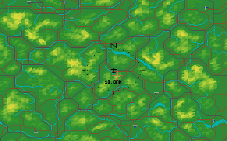

97. Big Map now works in 3 roles - as the original Big Map ('M' key), Split-Screen half-screen and in Explore mode
Mod: Big Map restored
By Frankie
Description:  Mod#96 resulted in the Big Map being displayed in half-height. The problem with that mod was that it broke the full-sized Big Map when the user hit the 'M' key. It also broke the VERY USEFUL EXPLORE mode which is commonly used in the briefings to scout the target area and to familiarise the armchair bomber with the shape and size of the target.
The good news is that I have solved the bugs and now when you play Tornado using this modded version of FLIGHT.EXE, you can
(1) hit the "M" key when in almost all views to view the full-screen Big Map;
(2) hit the F1 key followed by "]" for a different split-screen, up to the next nine times, and each time when you hit the "M" key, you will see the half-screen Map appear at the bottom half of the screen;
(3) at the main menu, click the Sub-Menu item "Explore" and you will be able to see a full-screen Big Map where after pressing Enter, it will bring you to the Explore 3D world where you can pan forwards, backwards, speed up, slow down, pitch up or down - using keyboard or mouse;

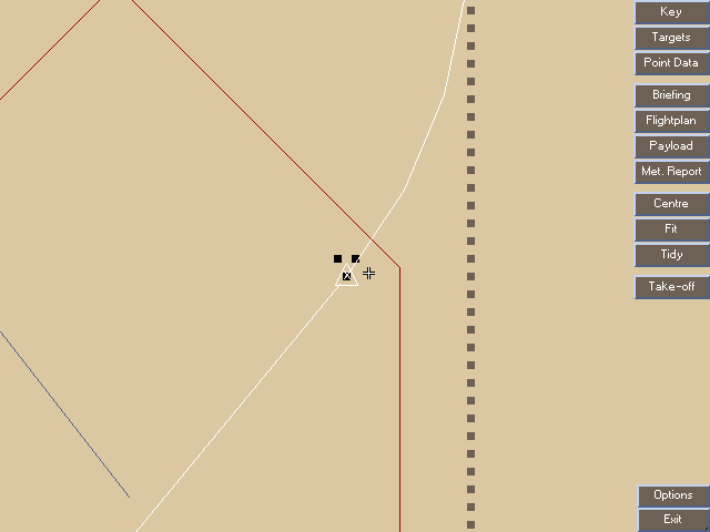

(4) at any Advanced Mission Planner screen, click the Sub-Menu item "Explore" and you will be able pan around the 3D world of the current mission.
So in effect, I managed to modify the source code MAPVIEW.ASM and MOVEMAP.ASM so that all 4 use-cases are bug-free, and you get the maximum gaming experience when using the Big Map or Half-Screen Map in Tornado.
Attached is the latest FLIGHT.EXE file.

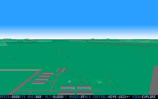

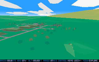

98. Explore mode improved
Mod: More goodies when using Explore mode
By Frankie

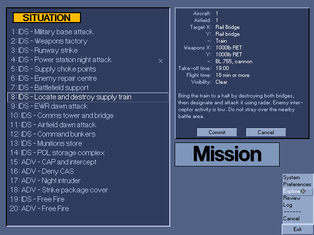

Description:  One of the key ingredients of Tornado is the excellent Advanced Mission Planner (AMP). Connected with the AMP is the Explore view. Tornado gamers would be wise to use the Explore View to scout out the target area and to make observations of its surroundings.
I have done these improvements to the Explore View.
(1) Hit Enter to get an instant directly-looking down view of the spot indicated by the crosshairs a screen ago.
(2) Initial view of the target area is now 1,000 feet directly above the cross-haired spot
(3) No more irritating flickering right after the Enter key is hit in (1)
Immediately after hitting Enter, in the stock game you had to pitch your view downloads to bear on the target.
In this mod, you are start by immediately looking directly down at the target.
(4) Up (dive) and Down (climb) arrow keys are now more intuitive
You can dive down to 16 feet with the Up ArrowKey. Conversely, climb with the Down Arrow key.
Scanning the target area, memorising placements and detail.
(5) You can change the pitch - via the '1' and '0' keys - only within certain limits. If the pitch of the screen reaches a certain positive or negative limit, you will not be able to change the pitch
View has been tilted up, but you won't be able to fill the screen with the sky!
Pitch is variable, but not a full 360%. Within limits. Use the '1' and/or '0' keys.
(6) To view the Explore Mode world in Night Vision green, hit the Shift+Tab key combination. This helps to better prepare you to visually identify the target when the mission is a night mission.
Attached is the FLIGHT.EXE file.
« Last Edit: October 05, 2024, 03:30:14 AM by Frankie »

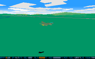

99. Shadow below the Tornado
Mod: Added shadow below the Tornado.
By Frankie
Description:  See that shadow below the Tornado in the screenshot below? It really brings out the 3D in the environment doesn't it? It gives the view an extra dimension of depth! Especially the ground. But Digital Integration's Tornado has never had a shadow. And never will unless someone modifies the code to add a variable-angled and variable-sized shadow below the Tornado. Until and unless that happens, this Mod#99 is but a mere dream. So this Mod exists only in an alternate universe. It isn't real. It's just a mock up, but it gives you an idea of WHAT COULD BE!
Cruising at 200 feet above ground.
The shadow makes a BIG difference, doesn't it?
But hey, after one year and a minimum of 98 modifications to the code, I can dream can't I?
FLIGHT.EXE not attached because there is none.
I don't think I will be completing Mod#99 anytime soon. It will be  a mini-project worthy of my humble programming skills. I will, however, require all the help I can get. If you have any knowledge how to do this, please do let me know. As for Mod#100, it remains to be seen.
« Last Edit: October 05, 2024, 03:30:28 AM by Frankie »

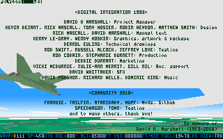

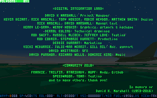

99. Restored Credits screen with Polygon count meter
Mod: Credits/Polygon screen
By Frankie
Description:  Giving credit where credit is due. With a polygon count to gauge the load on the PC's CPU in case of any slowdown when running FLIGHT.EXE on a retro 286/386/486 PC. Hit "\" and hold down, brings up the credits (centre screen) and polygon count (top left screen).
Note: if you are running the modded Tornado on an old PC (286/386/486 Intel machine), you can reduce more polygons by hitting these keys:
(1) '4' key - removes the clouds;
(2) '5' key - removes the horizon's gradient;
(3) If the Moving Map is active, Ctrl+LeftClick to zoom in;
(4) If the Half-screen Map is active, hit "<" to zoom in.
Attached is the latest FLIGHT.EXE. Enjoy.
And that's a wrap from me. It has been a great run! This is the 100th Mod and may Digital Integration's Tornado never be the same again. In fact I think it was already awesome before August 2018, but it is truly fantabulous this September 2018. One year has gone by and many a night was spent cracking my head to crack the assembly code's secrets. All this would not have been possible without the help from many people in the community. Among whom, Kevin J Bezant's advice and tips were invaluable. Credit to TailFinn for starting this journey's first steps on 3rd August 2018! You showed me that it was possible to compile, link and to create a brand new FLIGHT.EXE. That inspired me to try my hand at modifying the existing cryptic 16-bit assembly language code. What a journey it has been for me!  Thank you to Speedwagon for your kind words, inspiring thoughts and real-life pilot input into this project. Thank you to TomN for test piloting the modded FLIGHT.EXE and for getting me to remove trees from roads so that you can land your Tornado when no friendly runway presents itself. Thank you to ataribaby for showing interest in this project, enough to craft a mod for the Seitek analogue joystick. Thank you to mupf for getting the modded code on Github and for teaching me Githubese - how to clone, add, push and commit. May the code one day be ported to C. Thank you to everyone who joined the Tornado Discord Server, and to all who contacted me via my email and via http://www.tornado2.com (aka http://frankiekam.com) and http://frankiekam.com/tornado. Also to Graeme Mason for his July 2018 writeup on Tornado in Games TM Magazine. If I have left out anyone, it is because there are too many to thank.
A very special shoutout to Asid of Dogs Of War Virtual Unit for allowing me to host this Tornado modding journey and quest on the Dogs of War Virtual Unit forums. Cheers Mate. You rock. Braw, Bro.
Frankie Kam
« Last Edit: October 05, 2024, 03:30:44 AM by Frankie »

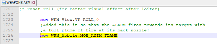

Description: I managed to restore the flame plume of the Indirect ALARM missile. When Tornado was first released in 1993, it was the combat flight simulator with a dizzy array of weapons management and modelling features. One of the best features of Tornado's weapons modelling was the Indirect mode ALARM. However, Tornado 1.0a had a bug in that the ALARM missile, in INDIRECT mode, did not animate its flame nozzle plume when diving towards the target. Tornado 1.0e's FLIGHT.EXE had this fixed - the plume of flame was present in the ALARM's dive. I always thought this  feature was sorely missed in the modded Tornado. After all, the source code is Tornado 1.0a, the very first incarnation of Tornado.
It's a pity that the source code for the patches Tornado 1.0b through to Tornado 1.0e are not available. If they were available, then the SAM proximity sound could have been restored to the correct sound file and code. To download the patches and their readme text files, go here: http://www.gamers.org/pub/archives/cactus/hitech-sim/patches/
Coming back to solving the lack of plume bug, the solution was very simple. I simply added the code mov WPN_Mobile.MOB_ANIM, FLAME in the "ALARM dive" section. Like so:
It's easy when you have the source code
