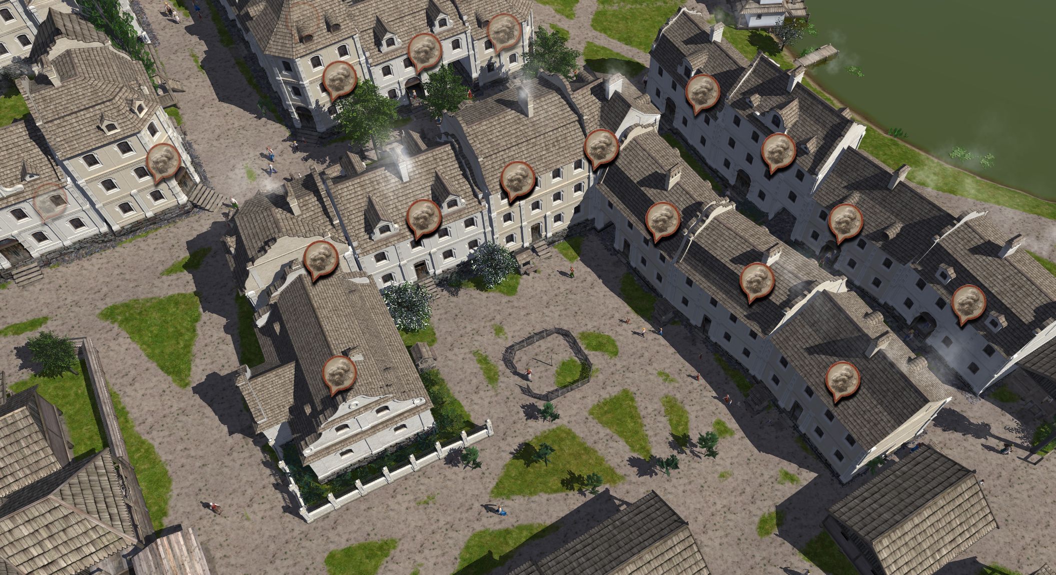

  •     Added icons showing dwellings affected by smoke pollution when hovering polluting buildings
