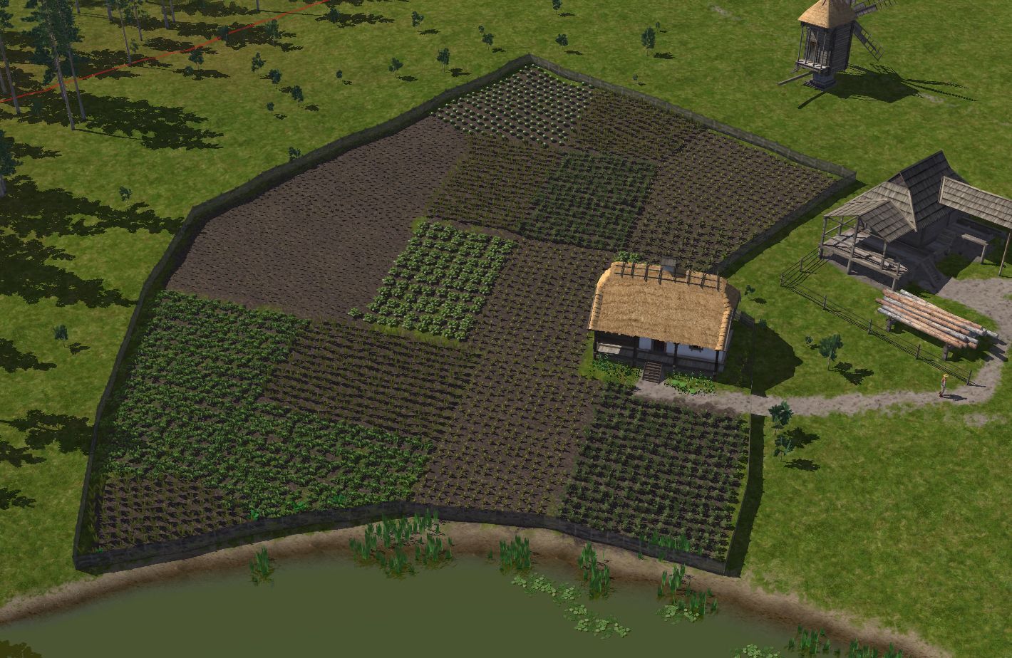

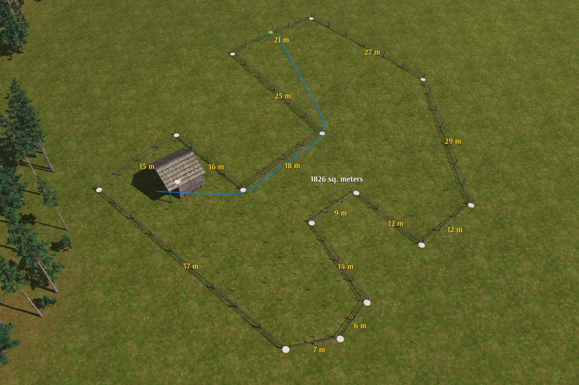

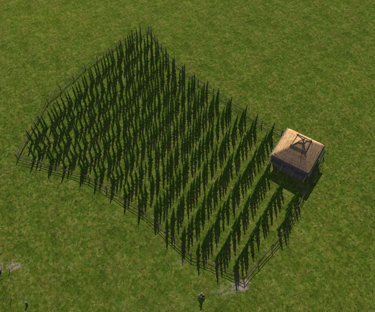

These recent weeks a few more buildings got a free-form upgrade, which I described in one of the latest posts. Village houses, orchards and hopyards are all going to be better suited for integrating to their environment.
The number of points is in theory unlimited, but you have to put them all somewhere. The maximum size will be increased as well to give more freedom for all your crazy ideas.

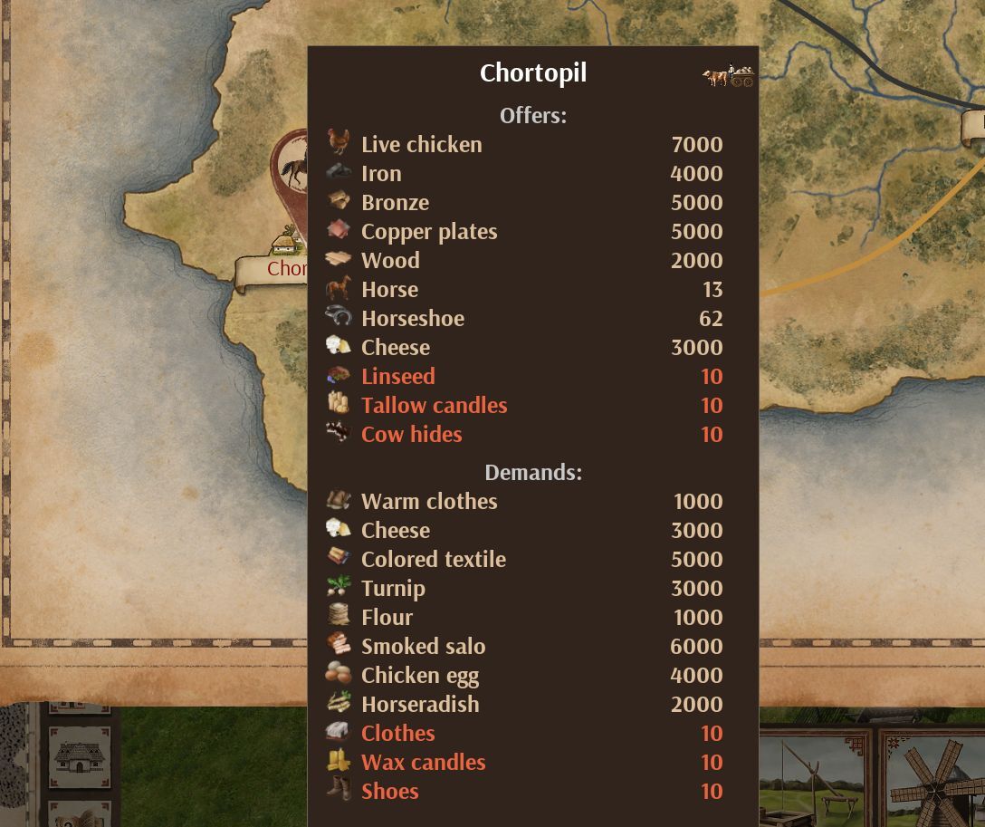

Another aspect which had some progress is trade. It should be less static and tedious with the time-limited offers and always-visible list of trade resources you can rely on.
(don't mind the numbers, they are temporary)
