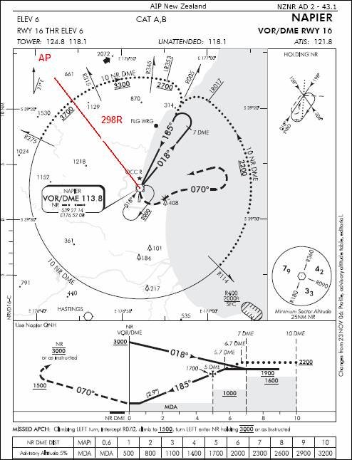

The published approach chart with the AP to NR track depicted in red:
Looking at our enroute navigation chart we can see that we will fly along the H211 airway from Taupo to Napier and that the required track is 118 degrees and as we get closer to Napier we will be tracking inbound via the NR VOR 298 radial.
If we now look at the Napier VOR/DME RWY 16 chart we can see that the NR 298 radial will put us on the arc segment between the NR275 radial and NR315 radial. Also note that it is a 10 mile arc (10 nm radius based on the co-sited NR VOR/DME and that we need to turn left to arc clockwise. Once we are on the arc we can descend to not below 3700 ft.
