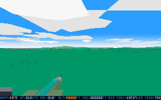

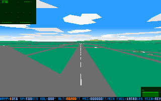

81.  When in an external view, the E-Scope display can be toggled on/off by pressing the 3 key
Mod: Weapons View with roll angle
By Frankie
Description: The E-Scope display is a pretty nifty tool when flying nap of the earth. One of the hallmarks of this classic flight simulator is its range of autopilot modes. Depending upon the mode selected, the autopilot will take control of your altitude (ALT), your heading (HDG) and your Indicated Air Speed (IAS). In Tornado, five(!) autopilot modes are available:

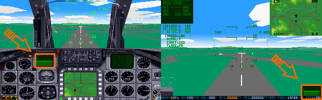

The E-Scope is modeled in Digital Integration's Tornado in the Pilot's cockpit as well as the modded full-screen HUD of Mod#38.
Two examples of E-Scopes already in the simulation. Left is stock Tornado. Right is modded Tornado.

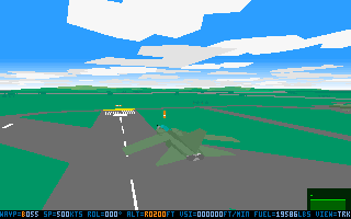

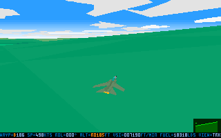

When you are in an external view, IF you are brave enough to hit the Escape button to cancel an autopilot mode, it would be very helpful indeed if you could see how far above the ground your Tornado is. With this mod, whenever you are in any of these views - Tracking View (F1), Reverse View (F2), Flyby View (F3), Spectator View (F4), Drone View (F5) - you can press the 3 key to toggle the E-Scope display on and off. The E-Scope appears at the bottom right corner of the screen. Like so:

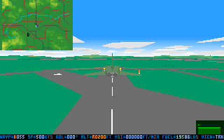

Buzzing the runway. You can see the E-Scope display at the bottom-right of the screen.
Climbing up a slope.

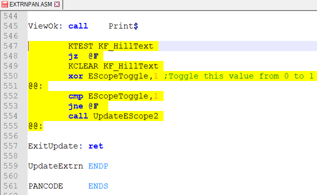

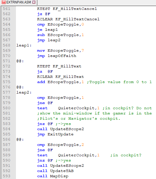

This is the code that allow you to toggle the E-Scope on and off when in an external view.

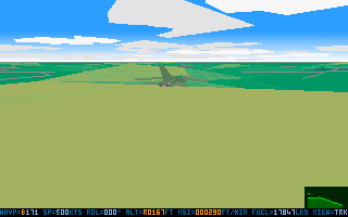

Levelling off at the peak.
Zooming down the mountain!
I think that the E-Scope is unobtrusive where it is, tucked away in corner. If you find it distracting, just hit the 3 key and it disappears. If you enjoy flying in Tracking View (F1) to enjoy or explore the Tornado scenery, you might want to enable the E-Scope just to keep tabs on the ground. After all, you wouldn't want to crash a 22-million Pound Sterling aircraft into the ground.
In my humble opinion, this mod HISTORIC because it is the FIRST TIME that an external view in Tornado has an overlay display, and a very useful one at that. It would be very interesting to consider and explore the possibility of overlaying, on demand, other displays. For example, one could consider the Moving Map display or the Waypoint Reference Map display as examples.
Note: as the 3 key is used for the E-Scope, you might realise that the Hill Textures on/off toggle (3 key) is no longer active with this mod. The turn off Hill Textures thingy is a throwback to the early 1990s. Back then PCs were slow. Every bit of extra texture hidden or turned off contributed to a faster framerate. Since we are now in 2018, I don't think we need the Hill Textures on/off toggle feature. It has been sacrificed for the greater good.

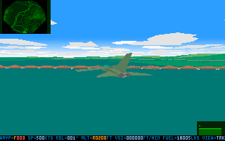

82.  When in an external view, multiple mini-displays can be toggled on/off in sequence by pressing the 3 key
Mod: Multi-mini displays with external views
By Frankie
Description: This mod is an extension of Mod#81. This time, repeatedly pressing the 3 key, when in any external view, will cycle through the following mini-windows:
  • Map display
  • Waypoint flight path display
  • Moving Map Reference display
  • Radar display - Ground Radar
  • Autopilot modes display
  • Instruments Landing System (ILS) display
  • Blank (no mini-windows)

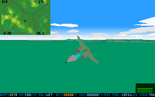

Each mini-window is accompanied by the E-Scope display which is located at the lower-right corner of the screen. See screenshots below.
The Map display. You can compare the 2D terrain with the 3D models represented by the external view.

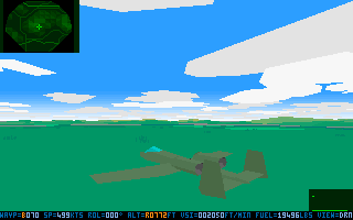

The Ground Radar display. Useful for night missions and for creating 'T' waypoints (Targets of Opportunity).
This display is mouse-enabled.

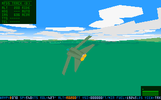

The Autopilots mode display. Useful to see this data panel when you are lazily enjoying the scenery.

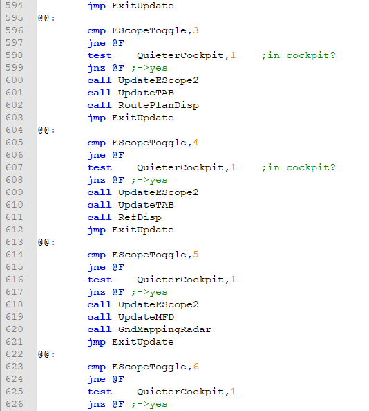

83.  When in an external view, multiple mini-displays can be cycled through forwards and backwards with 3 and Shift+3
Mod: Multi-mini displays in external views - can be cycled through back and forth
By Frankie
Description: This mod is an extension of Mod#82. This time, repeatedly pressing the Shift+3 key, when in any external view, will reverse cycle through the mini-windows. This is a usability improvement. Note: this feature only works with the IDS Tornado, not the ADV Tornado.
There is much satisfaction in seeing how Digital Integration, in 1993, managed to model the ground Radar which synced,
down to the split-second, with the outside 3D world and its objects (lake, road, bridge, military objects, armoured carriers, etc.)
The advantage of this additional code is that now the user need not cycle through a long series of displays in a one-way direction. Instead, the ease of cycling one way, and in the reverse way, makes for a convenient and easy to use interface for displaying the TV-TAB or MFD of the gamer's choice.
Above is the code that does the cycling forwards (key 3) and backwards (Shift+3)

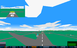

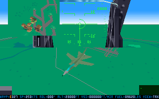

85.  Split-screen FLIR display
Mod: Split-screen FLIR display
By Frankie

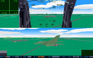

Description: This mod is an extension of Mod#84. When you hit the 3 key, an additional three objects will cycle sequentially:
1. TV-Tab sized FLIR display (top left of screen)
A FLIR picture inside a Tracking View picture. Try hitting F3, F4 or F5 for a surprise.

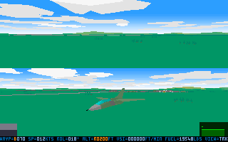

2. Half-screen sized set to a FLIR display (top half) and external view (bottom half) which you can change to F1, F2 F3 or F4 views.
Half-screen FLIR in action. Bottom half of screen is an interchangable external view.

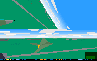

More split-screen stuff. Now I can see both directions at once from my Tornado!
Looking forwards and looking backwards at the same time.

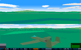

Bottom half of the screen is the Drone view. What this means is that you can now watch an ingress to the
target area from both your Tornado's and your wingmen's perspective. Endless possiblities.
3. Full-screen FLIR display which is steerable but without a HUD
Full screen FLIR view.
The whole idea of split screen was serendipity. Initially I wanted to have the map view overlapping the tracking view just to enjoy the Tornado 3D scenery and landscapes. So one thing lead to another and I discovered that Kevin already had the half screen display coded in the simulation. For example,  when you are in the Pilot's cockpit view (Home), the top half of the screen is half-screen height. So I just created an illusion of split-screen by overlapping a half-screen display on top of a full-screen display. So far the assembly language code is holding up. Occasionally I do see some horizontal black bar lines at the top left of the screen which is visually irritating, but does not impair the rest of the gameplay
So now the full complement of mini-windows initiated by hitting F1 key followed by 3 or Shift+3 is:

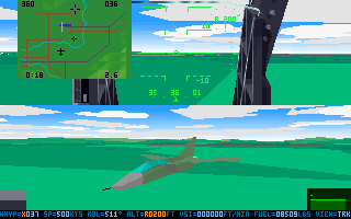

86.  Split-screen FLIR display with working HUD in top-half of screen
Mod: Split-screen FLIR display with working HUD
By Frankie

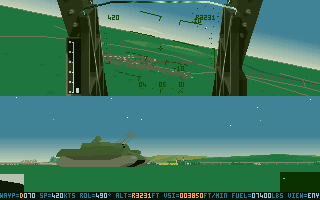

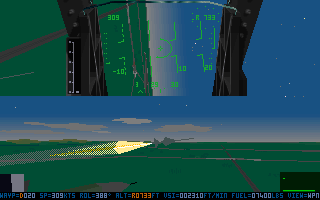

Description: Teaser. I managed to add the HUD into the top-half of the split-screen (activated with the 3 key, hit multiple times).
Work in progress. FLIGHT.EXE attached for you to try out. Slight bugs: cannon shells firing slightly below the ironworks gunsight; minor graphics glitch (not a deal-breaker) when running FLIGHT.EXE with the production Tornado installed with the CD-ROM or installation diskettes;
Bottom-half of screen shows the ZSU-23-4 to Tornado view
Video demo of work in progress. Hope to iron out the bugs by the weekend.
Lotsa action in this one. Wonders of assembly language - I am flying around in top-half of the screen,
and panning and changing the pitch of the horizon in the bottom half of the screen.
Attached is the working (WIP) FLIGHT.EXE. Cheers.

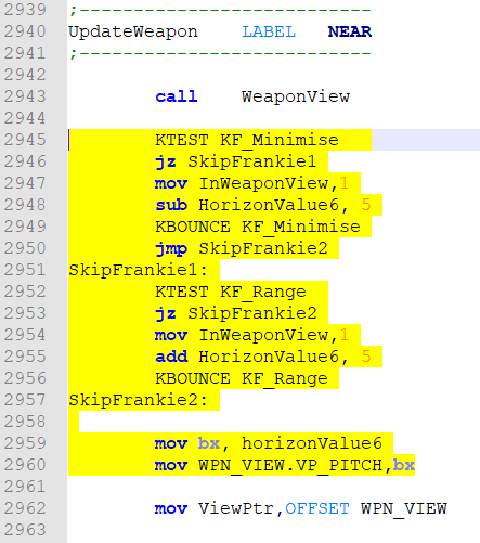

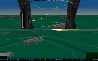

87.  Weapon View ('v' key) horizon can be adjusted up or down - works great with the Split-screen feature
Mod: Weapon View ('v' key) horizon is now adjustable
By Frankie

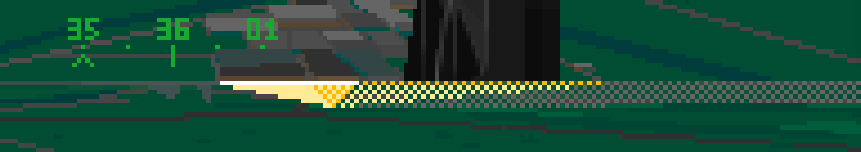

Description: Previously the Weapon View's pitch was static - i.e., non adjustable. I couldn't figure out where or how to adjust the pitch so that I could see more of the sky and less of the ground. In other words I couldn't shift the horizon. This became a problem because when I was in the split-screen view (F1 followed by key 3 - see Mod#86), the view of the ALARM missile (i.e., the Weapon) was partially hidden. See below:
I have fired off an ALARM missle in Direct mode. And I hit the Weapons key (V). Where is the missile?
It's mostly hidden because it's at the fault-line between the two horizontal halves of the screen!
You can see about 1/3 of the missile. It's plume of orange is clear to see. So I knew I had to solve the problem of the
Weapons View static horizon.

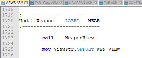

Here is the stock code of the UpdateWeapons label section.
Here's the code I used to solve the problem. The critical code are lines 2959 and 2960.
The code from lines 2945 to 2957 allow me to adjust the horizon up and down.

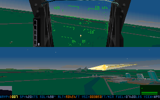

So the last thing to do is to test the modified Weapons View. Here's what the split-screen looks like now. The Weapons View is below.
Raining down death from above.
ALARM missile homing in onto its target and slicing through the air.
Success!

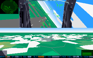

88.  Split-screen FLIR display with overlaid TV-Tab display and MFD (assembly language multi-tasking)
Mod: Split-screen FLIR, TV-Tab and MFD Combo in top-half of the screen
By Frankie
Description: Assembly language multitasking. Did you ever think that the Tornado code could show so many things on the screen at the same time? Now the permutations of cinematic screenshots and learning tools has been ramped up.
Here are some examples:
1. If landing the Tornado is your thing, you can enable this screen where you have the ILS system on the MFD whilst watching your Tornado glide towards the runway.
Landing never was my strongest skill in Tornado. Now I get to learn better and faster with the multi-tasking split screen.

to step through the modified views.
To directly go back to the Tracking View WITHOUT any TV-Tab or overlaid MFD mini-windows, hit the "3" key.
The Tornado code is a workhorse. So many possibilities.
What this mod does.
I have RE-attached the latest FLIGHT.EXE as of 5th Aug 2018, 9:07am Kuala Lumpur time.
I have thoroughly tested this version.
No graphics issues.

Just a lazy flight across the rolling European landscape. Flying mainly via auto-pilot across the plains and hills. If you like to multi-task, and have twenty minutes to spare, this video I uploaded to Youtube is for you. The two split-screen views plus the top-left TV TAB/MFD views give a challenge to the eye and brain as there is so much detail flashing every split-second.
Perhaps one day we can do the same for the desert dunes of Operation Desert Storm.
Video created from the modded FLIGHT.EXE with added 'split-screen' view. Truth be told, I just overlapped a 96-pixel height view on top of a 198-pixel height view to give an illusion of a split-screen. Actually it was not so simple. I had to angle the Tornado in the lower-half of the screen so that it would be fully visible.
Easily my favourite moment of the video. Flying over an expanse of water. Map, forward looking view and the external views are perfectly synchronised. 2D and 3D in perfect harmony. No visible lag in frame rates. Kudos to the original 16-bit assembly language source code, written by the then Lead Programmer Kevin J. Bezant!

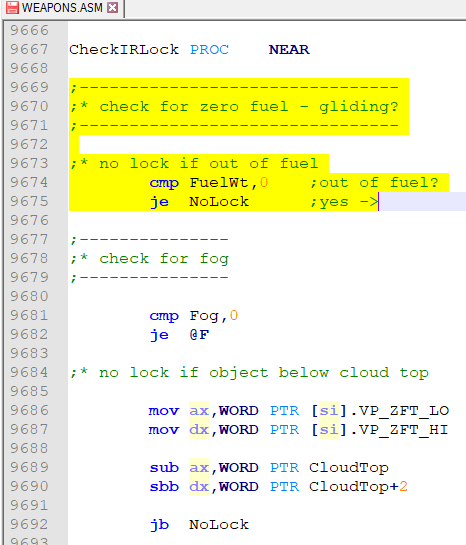

89.  Zero-fuel immunity against Infra-red seeking SAMs.
Mod:
By Frankie
Description: In the stock game, a Tornado in a zero-fuel situation would still be targetted by enemy Infra-Red seeking SAM sites. If you were gliding towards earth, your Tornado would be a sitting duck for enemy SAMs.
Just two lines of code is enough.
In this mod, I simply detect for zero kg of fuel, whereby the "no lock detection by IR missiles" setting would be set to on. So in a zero-fuel situation, your Tornado is no longer targeted by SAMs. Your Tornado is now free to glide and land on any runway or road unmolested by SAMs.
« Last Edit: October 04, 2024, 12:18:01 PM by Frankie »

SAM-testing already was done, now the new code had to be tested for AAA (not interfering) and for enemy fighters still firing radar guided missiles and cannon bullets, which they still do (off screen in other test flights).
This landing attempt was sabotaged by an air-to-air missile hitting the runway in front. Couldn't do anything about it so close to stalling, so i  collided with the crater.
  • Moderator
Re: Modding Tornado
« Reply #147 on: August 11, 2018, 03:52:57 PM »
Apparently the modded code is not very kind to the ADV F3 Tornado in the simulation. See 2:31 and 4:16.
I notice the two vertical black lines on the left of the screen. Sigh.

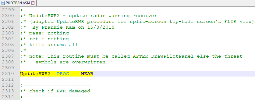

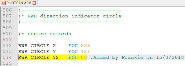

90.  Split-screen top-half-screen FLIR's HUD now has a superimposed RWR symbology
Mod: Functional RWR for split-screen FLIR HUD
By Frankie
Description: I felt that the split-screen FLIR could do with the RWR symbols showing it is HUD. After some sleuthing, I managed to nail down the code that is responsible for displaying this RWR display:
Source file PILOTPAN.ASM's UpdateRWR procedure is responsible for displaying the RWR on the cockpit. The constant, RWR_CIRCLE_Y, positions the centre of the RWR display at pixel-row 121.  So what I did was to create another constant, RWR_CIRCLE_Y2, which positions the centre of the RWR display, 41 pixels further up the screen, at row 80.
In addition, I copied the entire procedure named UpdateRWR and created a new procedure named UpdateRWR2 which accessed the contant RWR_CIRCLE_Y2. I had to be careful to make sure that the copied labels and jump to names were renamed so that there would be no duplicate jump names between the UpdateRWR  and UpdateRWR2 procedures.
Here is the result.
You can hit the '6' key to remove the ironworks. The RWR display will still be there, performing as expected. So that's the 90th post/mod of this Modding Tornado thread. Hope you enjoy it.
As always, I attach the latest FLIGHT.EXE file. Enjoy.
