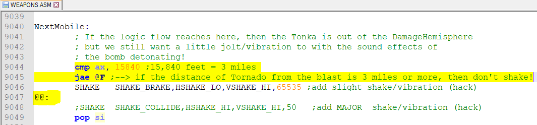

I suspect that because of Mod#13 http://dogsofwarvu.com/forum/index.php/topic,5046.msg25337.html#msg25337 where even if the Tornado is outside of a blast hemisphere, it will shake when a bomb detonates. So I think even if a bomb blast is hundreds of miles away, the Tornado will shake due to this code. If I am correct that it is indeed Mod#13 is responsible for this, then I add a code that check if the bomb blast is N (perhaps 3 miles is a good value to start with) miles or less away, the shake effect is still visible. However, any bomb blast that is MORE than N miles away, no shake is visible.
Update. Here is the code that I think will solve the problem. The latest FLIGHT.EXE file is attached.
Tom N
Thank you for this backward-improvement, though 5000 or up to 6000 ft (around 1 mile) should really be way enough and more realistic. Just my personal taste.
Thanks for car(etak)ing, Frankie!

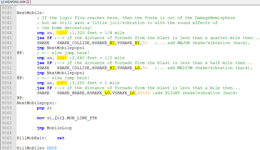

Based on your feedback, I have refined the code. Here you go.
Now the logic is
if Tornado is less than a quarter mile from the blast/denotation then
   Feel a major shake
else
   if Tornado is less than a half mile from the blast/denotation then
      Feel a medium shake
   else
      If Tornado is less than a one mile from the blast/denotation then
         Feel a low shake
      endif
   endif
endif
Here's hoping that this will reduce the 'jumpiness' and yet still give you the immersive feeling of experiencing bomb/SAM blasts which are in near proximity to your Tornado. Do let me know if this works (or doesn't work!) for you.

Hey Frankie,
I'll gladly test this!
EDIT: Testing done within 5 minutes with simulator mode, "IDS free flight", infinite fuel, infinite weapons, crash configuration (instead of "bounce"), i did not test for retarded bombs although i had them on board as well (forgot it)
Okay 2 things so far, the shakings are good for the GPB, shakings got stronger the closer i got to the ground from those 5000ft, then below 2500ft, no damage done to plane until going below 800ft, so this is quite right as the original damage parameter was (so all is good with the shakings and the damaging effects now)
HOWEVER ^^
the heading indicator seems to go haywire in external view F1", it works fine in the cockpit but outside it jumps to 360° when turning right from 179° to 180° to 355° ... to 4xx ° then beyond 5xx° back to normal, there is something awkward.
(doublechecked this now, since it has been in the video below, too), external view heading "hdg" works alright from 0° to 179°, so far.
kind regards, and good shakings now.

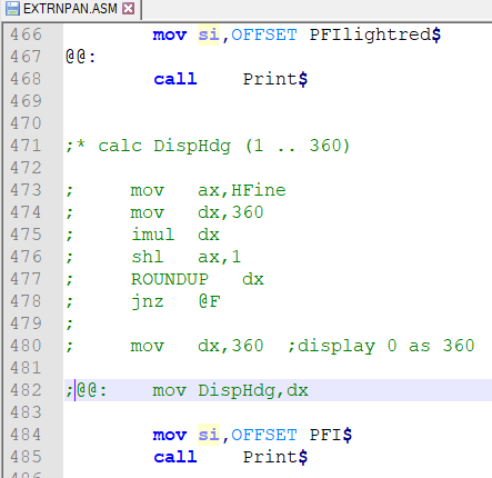

Frankie
#110
Hi TomN
I am happy to hear that the shudderings and shaking with the damage effects is better and more normalised.
As for the heading indicator, ah,  there was some additional code which overwrote the value of the DispHdg variable. Remnants of my earlier failed attempt to calculate the roll angle. Careless of me. I have commented out the offending code now. As you can see below, all the commented out code is shown in green font colour.
Please try the below FLIGHT.EXE program. The Display Heading indicator should now work as normal.

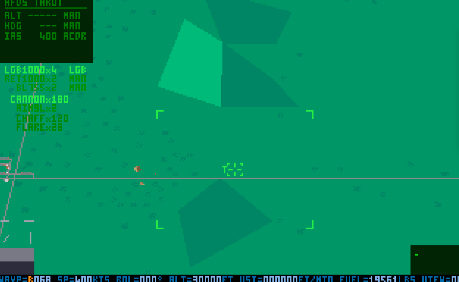

68. Adjustable horizon in Check Six! (F2) and Flyby (F3) views
Mod: Horizon adjustments in F2 and F3 views
By Frankie
Description: The horizon in the F3 Flyby view and F2 Checksix! views can now be raised/lowered. Previously the horizons in both views were fixed. Now you can press the keys "1" and "0 and the horizon will change its level. This is useful for creating variety in these two very useful external views. So now the F2 view is adjustable on both the horizontal and vertical axes. The F3 view however, is only adjustable on the vertical axis. Hope you find these modifications useful for producing interesting screenshots with DOSBox's Ctrl+F5 keypress.
Just hit F2 and then pressed and held down the "0" key in real-time to lower the horizon so that
more ground can be seen.
Just hit F3 and then pressed and held down the "1" key in real-time to raise the horizon so that
more sky can be seen.
See attached FLIGHT.EXE.

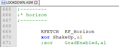

71. Shake effects, caused by damaged Tornado components, are now enabled by default and can be turned on and off at will by pressing the "5" key.
Mod: Damage shake effects can now be turned on and off at will
By Frankie
Description: The shake effect when the Tornado experiences damage (AAA, SAM, landing gear not raised in time, bomb blasts within the hemisphere of damage, etc.) is a double-edged word. Some love it. Some hate it. Now with this mod, you can now turn the effect on or off depending on taste. By default the shake effect has been turned off. Hit the "5" key and your Tornado will shake and vibrate, depending on the degree of damage inflicted by the game's elements (e.g., enemy fire, exploding ordnance, or gear, slats and flaps sloppy and careless treatment).
This simple hack of LOOKDOWN.ASM achieves a lot. It assumes that
you will never ever want to turn off the horizon's gradiented look.
Previously the "5" key was reserved for turning off and on the gradiented horizon. This is so 1993. PCs are no longer slow. So I hijacked the "5" key and used it to toggle the shake effects on and off. No apologies. After all, free key assignments are very hard to find in Tornado. This one was available so I grabbed the chance to use it.
Below is the latest FLIGHT.EXE which includes Mod#69, Mod#70 and M0d#71.

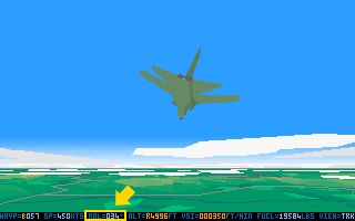

72. Roll Indicator Value in External panel's bottom status bar
Mod:  Roll Indicator Value
By Frankie
Description: When you bank the Tornado to the right, the Roll indicator value will cycle from 000 to 511. When you bank the Tornado to the left, the Roll indicator value will cycle from 511 to 000.
I have just rolled the Tornado to the right. "ROL" value reads "034".
This is useful in external views if you want to bank your Tornado left or right with micro-adjustments, but the rendered pixel-image of the Tornado is too small. In such a case, the visual numeric reading on the bottom status bar will be useful.

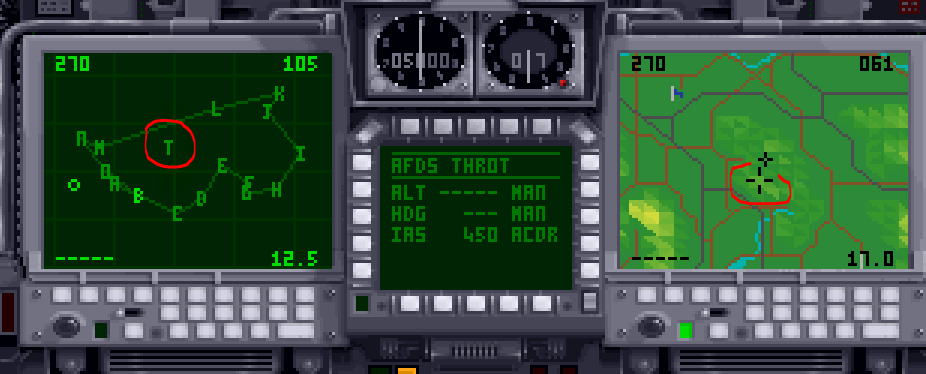

Tom N
Roll indicator looks fine enough!
Though meanwhile on the ground trees grow EVERYWHERE, even on roads, on which i want to land!!
And moving around on the backseat TAB-map is impossible, sadly, so putting the optional target marker "T" is no option any longer. That's BAD! Forgive me with picture 3 and "NormallY".

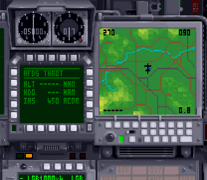

#117
Hi Tom
Thanks for testing the FLIGHT.EXE. I tested the back seat map view using the FLIGHT.EXE of 17th June 2018, and it works. This FLIGHT.EXE was corrected so that the map view is scrollable and the 'T' waypoint works. For your convenience I have attached the latest FLIGHT.EXE file with this post in the form of FLIGHTMT.EXE  (MT stands for Modded Trees). Rename FLIGHTMT.EXE to FLIGHT.EXE and Bob's your Uncle.
Moving with my mouse on the Map View and clicking it to create a "T" waypoint.
Make sure you use the 17th June 2018 version of FLIGHT.EXE which corrects a bug from earlier versions.
"T" waypoint with the 17th June 2018 version of FLIGHT.EXE.
Perhaps you downloaded and tested the FLIGHT.EXE from before 17th June 2018?

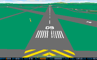

Tom N
#119

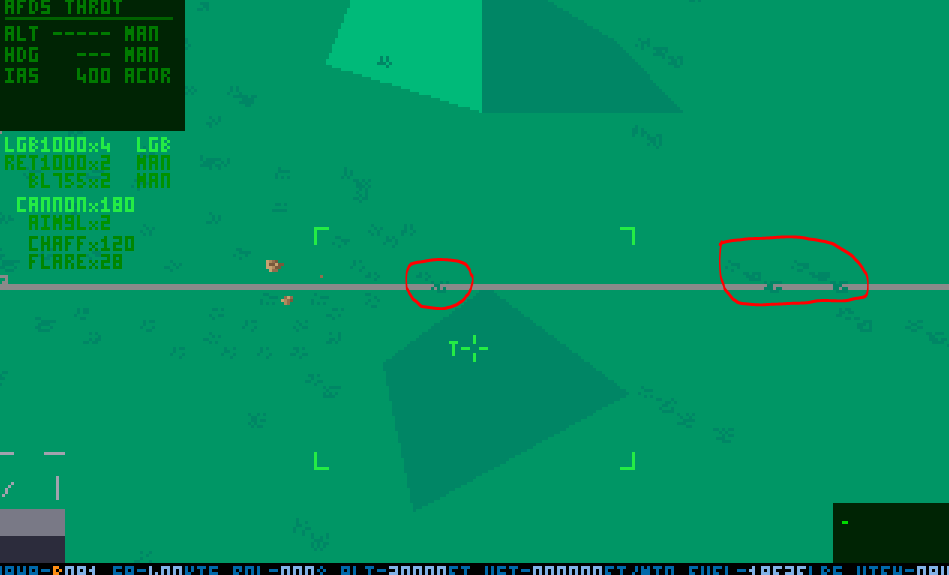

Uh oh, Frankie, I think we get some strange artefacts on ground:
(I used the no trees flight.exe --> flightnt.exe)
Should i try to land on that?
EDIT: better 2nd picture, airplane nose to the south, airplane located east from the starting airfield of simulator "IDS free flight" mission.
Debriefing shows:
"ground speed too high
Heavy Landing
injured"
so that's not paved!
It even was one of my slowest approaches: 130 kts speed, 7 fps vs
And yes the backseat TAB-map "T" waypoint function works again ^^
