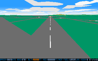

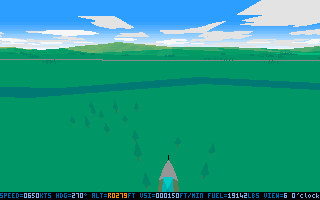

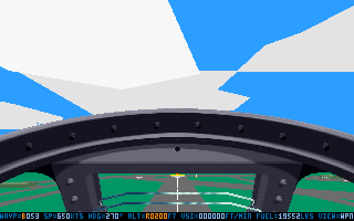

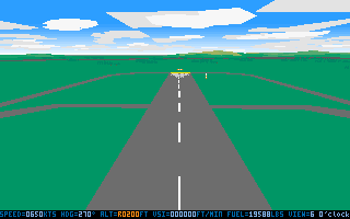

Okay, let's switch to the reverse view in one fell swoop...hit the F2 key!
The normal Check Six view. The runaway is retreating into the background.
Ah nice! But what if I want to look around to the left or to the right?

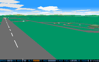

I have now added the ability to pan left (wth Z key) and right (with X key). This gives better situational awareness if one uses the Check Six view a lot. It also allows the user to have a nicer 'look see' to survey the reverse view.
User has just held down the 'z' key. View slews to the left.
Plane is still flying on course.

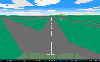

You can now slew, on the horizontal axis, a full 360 degrees. This is what the user sees if he slews all the way to the front view.
User has held down the 'x' key. View slews all the way to the front.
User is now looking forward towards 12 O'clock.

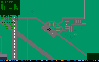

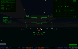

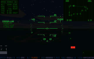

We're right on top of the Enemy airfield. Where is it?
The user has just hit Shift+Tab. Ah there it is! As clear as day.
Again, it's pitch black out there. The enemy has intentionally turned off and dimmed the lights.
With the NVG (Night Vision Goggles) mode, the enemy can't hide.

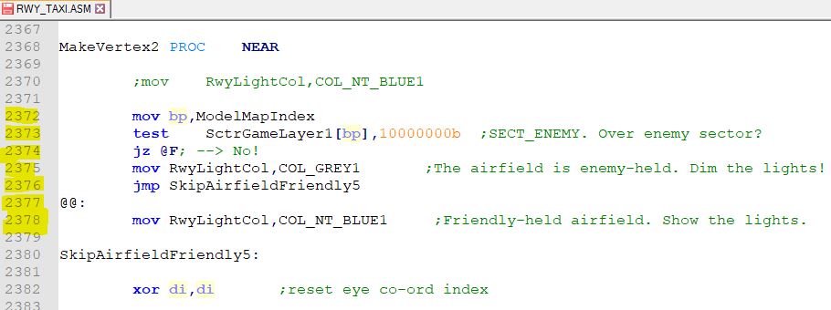

Part of the code responsible for this injection of 'realism'

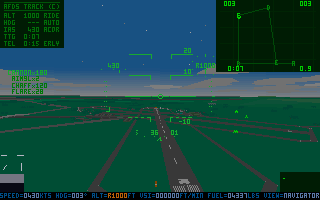

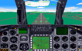

Here is a friendly-held runway. See the runway lights?
Another view of a friendly-held runway. Lighted up like Christmas tree.

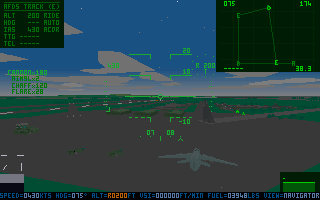

An enemy runway at dawn. Again no lights are on - a blackout even at dawn.
Another dawn view of a busy enemy runway. This mod douses the lights.
In contrast, here is an Allied-held runway. The runway lights are on.

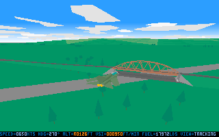

Just another day buzzing the countryside in Tornado.
This time flying past a red bridge.

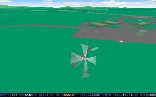

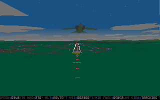

Tracking view (F1). The Tornado is about to hit Target waypoint Y
Notice the waypoint shown at the bottom left of the screen in orange alert color?
That waypoint letter makes a BIG difference to the external view!
Keep an eye out for the WAYP=X information at the bottom left of the screen.

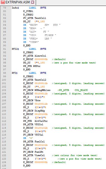

This code, in the ASM file named EXTRNPAN.ASM, does the trick.
The waypoint letter shown at the left corner on the screen (e.g., WAYP=Y) is dynamic and will update itself in real-time. Hope this mod adds to the immersion of the game for you.

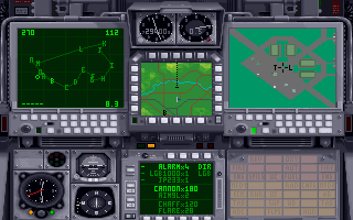

The famous TIALD view in the Navigator's cockpit. A 1993 sensation

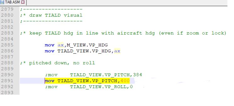

Back in late 2017, I discovered that by setting a larger TIALD_VIEW.VP_PITCH value, the TIALD view could be angled so that the view becomes be more 3D. I did this modifying the code on line 2893 of TAB.ASM. Specifically changing the value of 384 to a larger value like 400.
Changing 384 (looking straight down) to 400 (looking at an angle) gives a certain perspective
to the look and feel of the TIALD view.

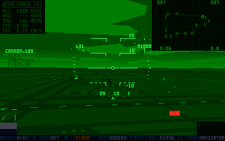

Unfortunately there was a problem which I couldn't solve. The problem was that whenever I zoomed in with Control+HoldMouseLeftbutton, the zoom point was always lower than the crosshairs merge point. Which also meant that the LGBs would always hit the area before the actual target. Today, I decided to revisit this old problem. It took quite a while of poking through the code before it struck me that I didn't need to bother with recoding any of the mathematical and trigonometry logic. All I needed to do was to display the entire crosshair complex lower down the screen.

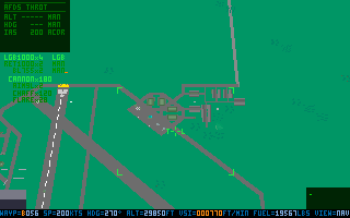

This code allows the entire TIALD crosshairs and its four right-angled corners to be displayed 25 pixels lower down the screen.
I tested this and it worked just fine. You can detect a difference in the perspective of the view - it has a more 3D feel to it, thanks the change in PITCH value. Try panning the mouse left, right, up and down. The landscape and environment feels more 3D-ish, and more exciting compared to the its top-down forerunner.
The crosshairs are now lowered so that it occupies more of the bottom half of the screen.
Panning around now has a nice 3D perspective to it.
The best thing about this mod is that, from my testing done so far, the laser guided bombs hit spot on at the new location of the lowered crosshairs! Thus the TIALD view has now evolved into a more 3D experience for the Tornado gamer.

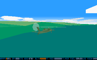

62. Vertical height of Drone views (F5/Shift+F5/Alt+F5) can now be adjusted with the 1 and 0 keys
Mod: More exciting Drone Views
By Frankie

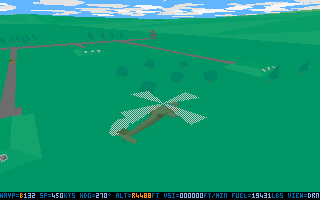

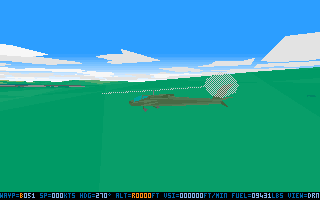

Description: Previously Drone view heights could not be adjusted. Below are some standard drone views (F5/Shift+F5/Alt+F5). In the three screenshots below, the views can be slewed right and left with the Z and X keys, and pitched with the drone banked left or right. However in each of the three views below, the vertical perspective could not be raised or lowered.
-and-
-and-

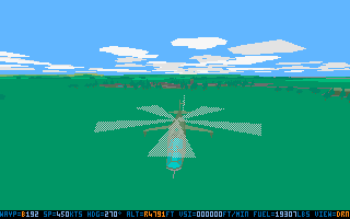

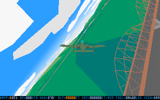

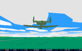

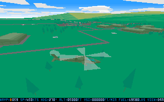

Now with this mod, you can adjust the Drone Views by pressing and holding the "1" and "0" keys. Below are a sample of views and perspectives now possible!
-and-
-and-
-and-
-and-
-and-

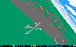

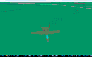

I have also added in the Alt+P key which shows a pitched view of the aircraft. For example, see the two screenshots below:
Plane is banking...
...this is what I see when I hit Alt+P.
