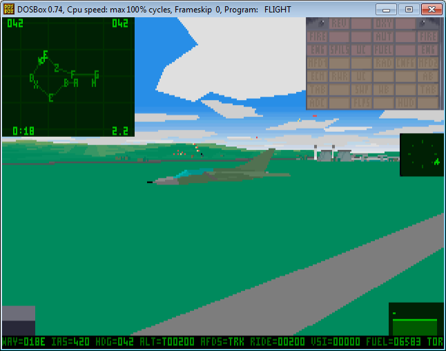

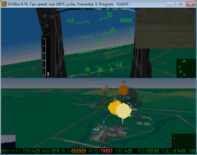

127b.  Muzzle Flash and Firing Effects Of Soviet Anti-Aircraft Weapons - Part 2
Mod: Added firing effects for ZSU-23-4 and ZRK ZOMB (SA-8) - Solved the 'DosBox hang' bug of Mod#126 and Mod#127.
I managed to solve the bug which hung your DOSBox if you ran the FLIGHT.EXEs of Mod#126 and Mod#127. The corrected FLIGHT.EXE retains the "Reworked splash effects used for JP233 explosions and craters." found in Mod#126.
This latest FLIGHT.EXE also re-centres the ALARM countdown clock in the full-screen FLIR mode (Shift+D) (a coordinate bug which went unnoticed, until today that is!).
Most importantly, the game now NO longer hangs during your ALARM runs against enemy Shilkas. See attached the remedy FLIGHT.EXE.

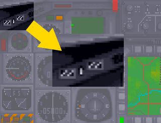

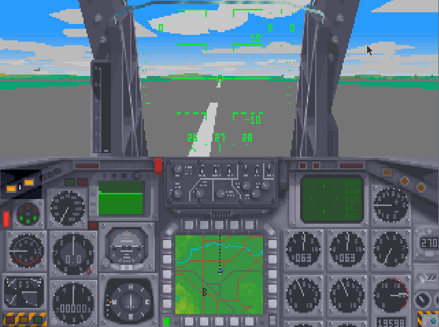

128.  Restored the Fuel Indicator Counter to the Pilot Panel (Cockpit)
Mod: Fuel Weight Counter ala Tornado 1.0E

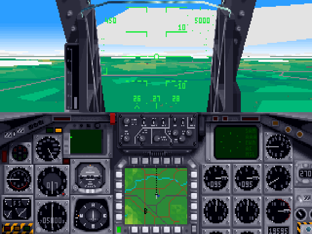

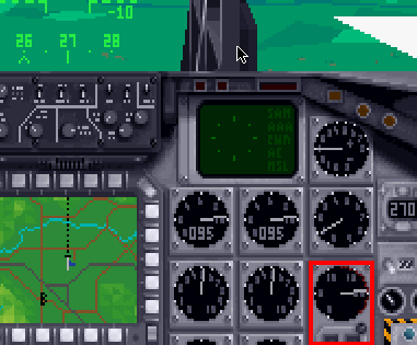

In Tornado 1.0a, the fuel gauge looked like this:
Technically and design-wise, Digital Integration was spot on with the gauge. The real one looks like this:
The analog fuel gauge that Digital Integration modeled did not tell you the exact amount (actually the weight) of fuel left. You needed to hit an external view key (F1, F2, F3, F4 or F5) to see the fuel counter at the status bar. So perhaps for this reason, Tornado 1.0e modified the look of the Fuel Gauge to display the Fuel Indicator digits. Since the Tornado source code is Tornado 1.0a, the Pilot Panel (cockpit) sadly lacks the numeric fuel weight counter that made its debut in Tornado 1.0e. Too bad that one would need the services and expertise of Dr Indiana Jones to track down the source code of Tornado 1.0e! The good news is that with very little work and effort, you can have that counter back where it rightly belongs! Just follow these three steps.

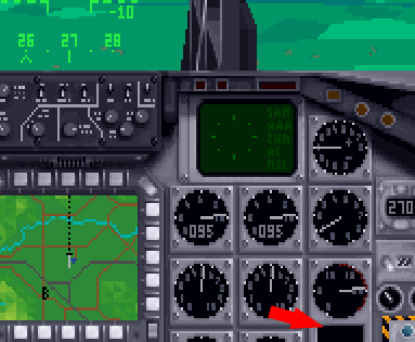

Step#1. Get the right PILOTPAN.BT2 file
  • Rename your current D:\TORNADO\TORNADO\FLIGHT\PILOTPAN.BT2 to D:\TORNADO\TORNADO\FLIGHT\PILOTPAN_ori.BT2
  • Download the file PILOTPAN.BT2 (see the attachments section below!)
  • Copy the file PILOTPAN.BT2 to the D:\TORNADO\TORNADO\FLIGHT subfolder
Re-compile PILOTPAN.ASM, and link a new FLIGHT.EXE executable. Your Pilot Panel will look like this:
Where are the digits of the Fuel Weight Digital counter? All I can see is a black rectangular void. Almost there! On to Step#2.

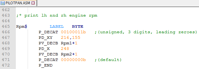

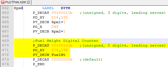

Step#2. Modify the PILOTPAN.ASM source file
Open the source file D:\TORNADO\TORNADO\PILOTPAN.ASM and go to modify the rpm$ definition from this....
...to this:
Now after you have saved and compiled PILOTPAN.ASM, and linked a new FLIGHT.EXE executable, your pilot panel will now sport the much missed Fuel Weight Digital Counter.
At last, the fuel weight digital counter is restored.
You may download the latest FLIGHT.EXE file. Now the modded Tornado is even more complete! Many thanks to Mandjare for requesting this mod.

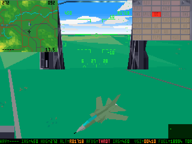

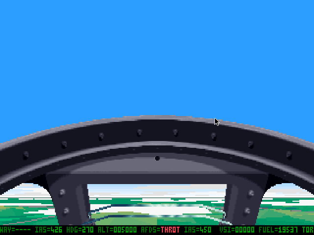

129.  Restored the LookUp View (Pilot's Cockpit) with improvements
Mod: Improved LookUp View and some other bug fixes

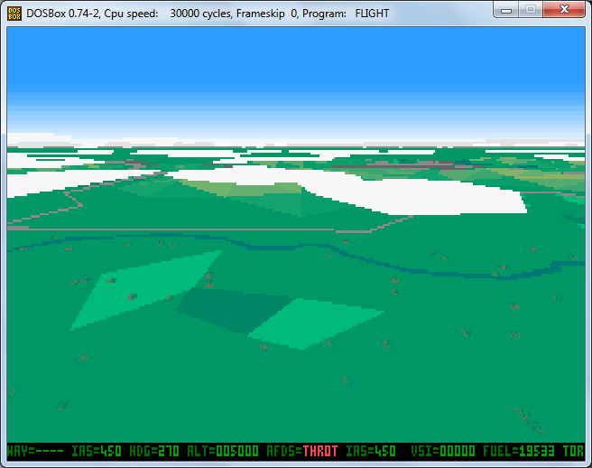

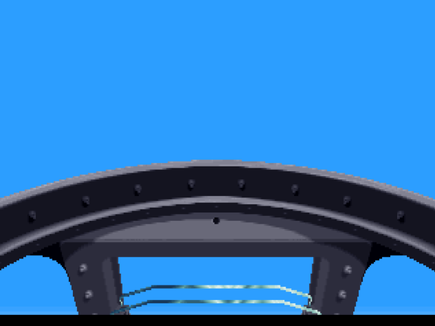

In Tornado, hitting the Home key twice yields the Lookup view. Here is the default Lookup view of out-of-the-box Tornado.
In Mod#124 I removed this default Lookup view! I thought it was 'useless' since it seemed to me
more suited for Tornado ADV missions, what with its total emphasis on the sky.
Recently, I have been informed by Mandjare78 that "this function was very useful for a real Tornado pilot in low flying, as to predict the next turn between hills and mountains." I never knew that! I always thought the second Home key was for air-to-air (Tornado ADV) combat, which was pretty useless to for me, since 90% of the time I am flying the Tornado IDS!
So now that I've been informed how important the view is, I've restored the original "sightpoint above the canopy rail" feature. With FIVE improvements.
(1) I raised the horizon a bit so that now you will see majority of sky with some earth. This should help orientate the gamer.
You can see an unobstructed view of the horizon, with a status bar to boot!
(2) The Lookup view now comes with a status bar. More information to the gamer. I had to modify the LoadFramePan procedure of the  FRAMEPAN.ASM file so that the status bar is flicker-free.
(3) I have made the free-style external view (see the third screenshot of my previous post here) as the third Home key press.
Hitting the Home key a THIRD time gives you this nice external view of Mod 122-124.
You can pan this view left (z key) and right (x key), and pitch up (0 key) and down (1 key)
(4) A fourth Home key press will cycle the gamer back to the PilotPanel view. A slight inconvenience of having to toggle/cycle through three Home key screens, but balanced by the increased functionality and gameplay made available.
(5) Fixed a graphics bug where hitting Control+F5 (Change Drone Type) will cause a screen anomaly in many views (Pilot View, Lookup View, etc.). I modified the MODEL.ASM and VIEWS.ASM files for this.

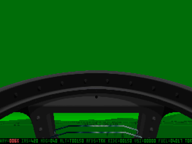

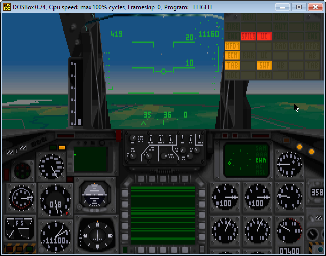

Six seconds away from the target. Trees are whizzing by at 420 knots, 150 feet above ground.
The Lookup view in gorgeous green Night Vision colours
See the latest attached FLIGHT.EXE.

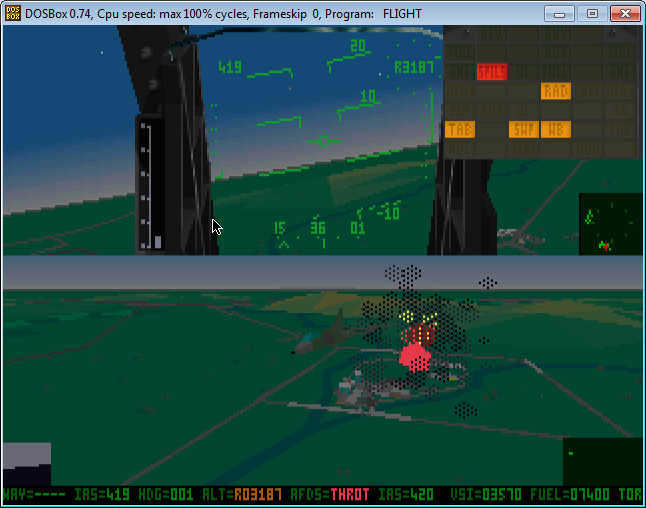

130.  SPILS manually turned off with cell cue; missile bug fixed; less irritating rumbling
Mod: Added SPILS on/off light cue on Navigator's Damage Panel and other bug squashes/improvements:

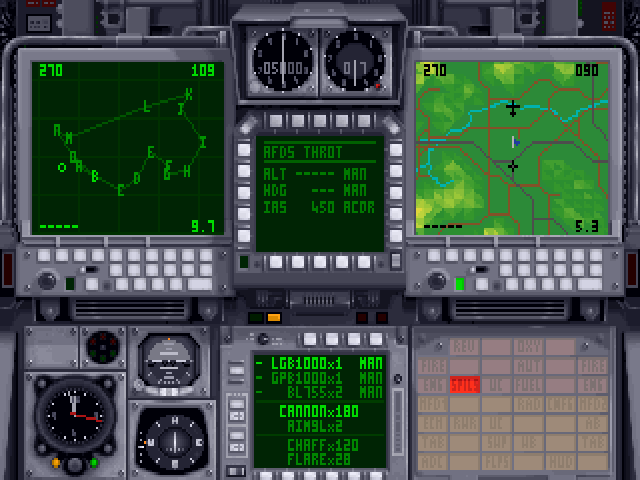

1. SPILS MANUAL TURN ON/OFF INDICATOR
SPILS stands for "Spin Recovery and Incidence Limiting System". In Digital Integration's Tornado simulation, the Navigator's Central Warning Panel "off light" for the SPILS is only active if the SPILS is damaged, for example by a SAM or AAA hit. In the game, you can hit Control+I to toggle the SPILS on and off. However, as stated in the Tornado game manual on page 202, "be careful when you do this: just hit the key once, because the control toggles SPILS on/off and there's no indicator apart from the one on the warning panel in the back (Navigator's position), which only illuminates when the system fails due to damage, and NOT when you switch it off deliberately."

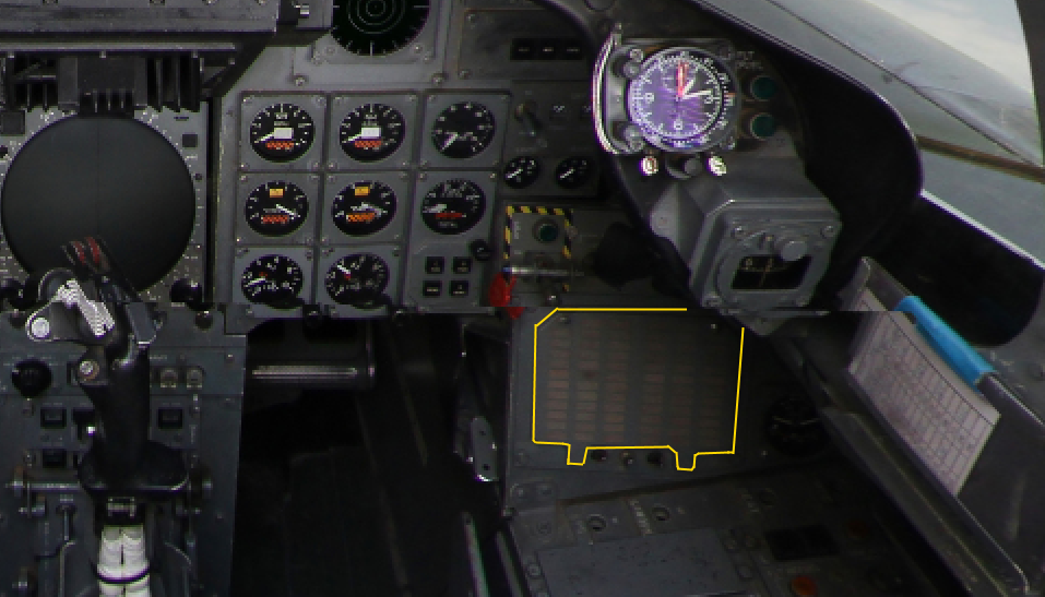

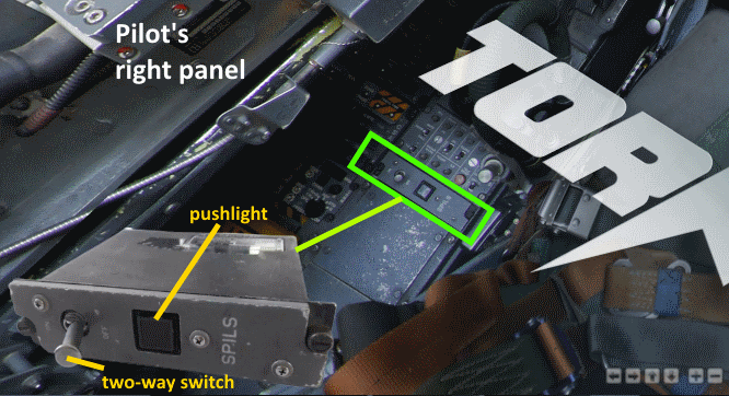

The actual SPILS hardware
In reality, there is a SPILS light that turns on when the Tornado pilot deactivates the SPILS by hand (in the sim with the keys "Control + i). Unfortunately this light is positioned on inside-right side panel of the pilot cockpit. DI's Tornado does not model the Pilot's right and left panels.  The Pilot's side panel contains a two-way switch to activate and deactivate the SPILS system. It also contains a push button to self-test and/or reset the SPILS system. When SPILS is manually deactivated with the 2-way switch, the pushbutton will light up.
Simplifying the whole process. Hit Control+I to toggle the SPILS cell indicator on and off.
If the SPILS is damaged by enemy fire, the cell stays lighted in red.

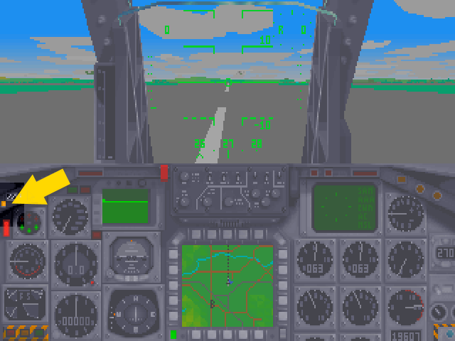

In this mod, I have integrated this automatic function with the manual THR system. I have modified the MODEL.ASM so that the THR will engage upon touchdown. I have also implemented a safety feature in this 'automatic mode' - the THR will automatically disengage when the Tornado's speed, after landing on the runaway, reaches 25 knots. This is to prevent your Tornado's engines from "re-ingesting their own exhaust, which will do them no good at all" (Digital Integration's Tornado Manual, page 145). After the THR has automatically disengaged at 25 knots, you may re-engage the THR manually by hitting the Backspace key.
The left and right Thrust Reversers indicators are shown on the left of the Pilot Panel.
Both are engaged as shown by their orange lights

Mod: Control+Backspace toggles the automatic Thrust Reversers on and off. Light indicator for the auto-THR as well.
Now you can choose to land your Tornado with the THR system automatically kicking in upon landing, OR you can decide to control the THRs yourself with the Backspace key. To select the auto-kick in THR system hit the Control+Backspace key. I've taken the liberty to add my own indicator light as a reminder to the virtual Tornado pilot that the THR is in automatic mode. Too bad 640Kb wasn't enough for Digital Integration to add the Pilot's side panels with all their instrumentation, gauges, lights and switches.
When Control+Backspace is hit to select the auto-THR mode, this light indicator turns on.

1. It's an accurate (as per real life) THR selectable manual/automatic switch indicator; See the "before hitting Control+Backspace" and "after hitting Control+Backspace" screenshots below.
THR selectable manual/automatic switch indicator is turned off (position is down).
This means that upon landing the thrust reversers have to be engaged manually with the Backspace key
THR selectable manual/automatic switch indicator is turned on (position is up) with Control+Backspace.
This means that upon landing the thrust reversers will engage AUTOMATICALLY!

« Reply #252 on: June 29, 2019, 04:29:40 PM »
136.  Modelled Central Warning Panel (CWP) in the Pilot's front station (cockpit)
Mod: Pilot's Central Warning Panel
After 26 years, DI's Tornado finally has a more complete Pilot's cockpit like its real-life counterpart Tornado GR4 - a working Central Warning Panel (CWP) inside the front station!
If you surf to https://www.panavia.de/multimedia/360-cockpit you will see a magnificent 3D rendering of a Tornado's Pilot cockpit. At the right side of the image, you will see the Pilot's CWP.
A pannable and zoomable cockpit.
The pilot's CWP which mirrors the exact same red and amber warning cell lights as the Navigator's CWP. Zooming in, we can see the CWP more clearly....
Zoomed in closer.
...and this is what the actual component looks like:
Due to memory and space limitations, DI's Tornado modelled an incomplete Pilot's cockpit. One that is missing the Pilot's lower left and right panels. The Pilot's CWP, which is located in the Pilot's right panel, is not modelled in out-of-the-box Tornado. On 27th June 2019, Mandjare78 requested if I could add the Pilot's CWP in the front cockpit of DI's Tornado simulation. He asked if it were possible to create the Pilot's CWP as a window overlay - one that could be toggled on and off with the push of a button. Ideally a single key press instead of a Control+keypress or (God forbid!) a Control+Shift+keypress.
After much hard work and sleuthing around, plus a great deal of serendipity and luck with the code, I managed to do this:
Pilot's CWP - A DI Tornado first!
I managed to figure out how to toggle on and off the 'floating' Central Warning Panel (CWP). I used the Scroll Lock key to toggle on and off the CWP. The CWP stays put until I toggle it off. My mind is lazy and doesn't want to recall what the CWP looks like if it appears and vanishes. So by staying put, it allows me time to look at the warning cells and to process the information. Less hurried, LOL, never mind that the plane is being shot to pieces, I like to take my time to look at a static window with flashing red and amber cells, LOL again.
The CWP is triggered by Scroll Lock and it is PERSISTENT. Meaning it will show on top of ALL and ANY view (even the Splitscreen and Map views!), until and unless you hit Scroll Lock again to toggle it off. The only view it doesn't show up is when you are in the Navigator's cockpit (after you have hit PgUp key) because the Navigator can already see the CWP at the lower-right corner of the screen.
Pilot's CWP in split-screen action
The BIG picture is that now that I know how to copy a certain section of a cockpit with the gauge readings that accompany that section of the cockpit, it is VERY POSSIBLE to reproduce any section of the cockpit anywhere in the game. The only limitation would be the code stack memory (memory space allocated to keep the compiled source code) when the source code grows bigger given each additional new feature like this toggled on/off CWP.
What's the effect of the CWP overlaid window? As in the real Tornado pilot (these days in Germany, Italy and Saudi Arabia), with this extra information at hand, it provides a BIG PLUS to the tactical awareness of the virtual DI Tornado pilot. If you were to do a ground strike mission, one where there is heavy AAA and SAM-inflicted damage on your Tornado,  it will be great to have all that damage information directly displayed in the front station. So this is an example of a mod born out of 'necessity' which greatly enhances the situational awareness of a flight sim, leading to enhanced gameplay.
Here is the latest FLIGHT.EXE, together with the key source code assembly language files that I modified.
Many thanks to Mandjare78 for his idea of the Pilot's CWP. From his idea we now have this mod which makes DI's Tornado even more realistic, fun and immersive.
Cheers to all DI Tonka fans!
Frankie Kam

138.  On-Demand Radar Warning Receiver (RWR)
Mod: Added the RWR to all screens except the in-cockpit Pilot and Navigator stations
Hit the Grave Accent (`) key on your keyboard to toggle the RWR on and off.
Location of RWR is fixed to the right edge of the screen, centred vertically. I thought the RWR would come in useful in the external views, especially the split-screen with HUD view. Like the one below when the action gets fast and furious.
A little help from the RWR goes a long way to knowing where the threats are.
As you can see, all the threats are at six to twelve o'clock of the HUD.
A moment later and my Tornado is in BIG trouble.
Running the gauntlet of AAA fire coming from my three o'clock.
Finding the location to place the RWR was tricky. I chose a location that was unobtrusive and which I think is suitable for split-screen action. The centre of the right edge of the screen. If you don't like the position, you can always toggle off the RWR with the Grave Accent key on your keyboard. If your keyboard doesn't have the Grave Accent, then let me know and maybe I can think of a solution. The problem is that this Grave Accent key is the last unused single-press key on the keyboard! Tornado as a simulation has been brutal on the keys usage of the standard keyboard. All single-press keys have now been used up. The final three that I added to Tornado were the Scroll Lock, the Front Slash (/) and the Grave Accent (`) keys. Possible other keys exist, but they'll have to be the dual key presses like Control+key, Alt+key or Shift+key variety. Not ideal, but still useful.
Most Tornado gamers fly from the Pilot and Navigator stations, not the external views. That being said, IMHO, the RWR adds a situational awareness factor to the simulation. It may not be entirely realistic for all scenarios, but I hope you enjoy the addition of the RWR as you find creative ways to utilise it in the missions and campaigns.
Attached is the latest modded FLIGHT.EXE.
