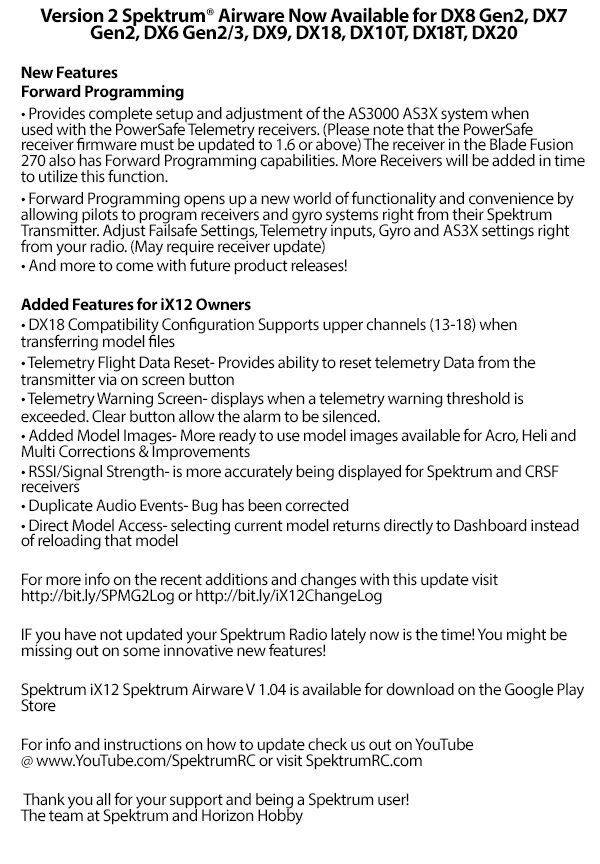

New Features for Spektrum Radios Available Now!
(25 April 2018)
Version 1.21 (DX6e, DX8e)
Version 2.00 (All others)
download the Software Update Read Me file
