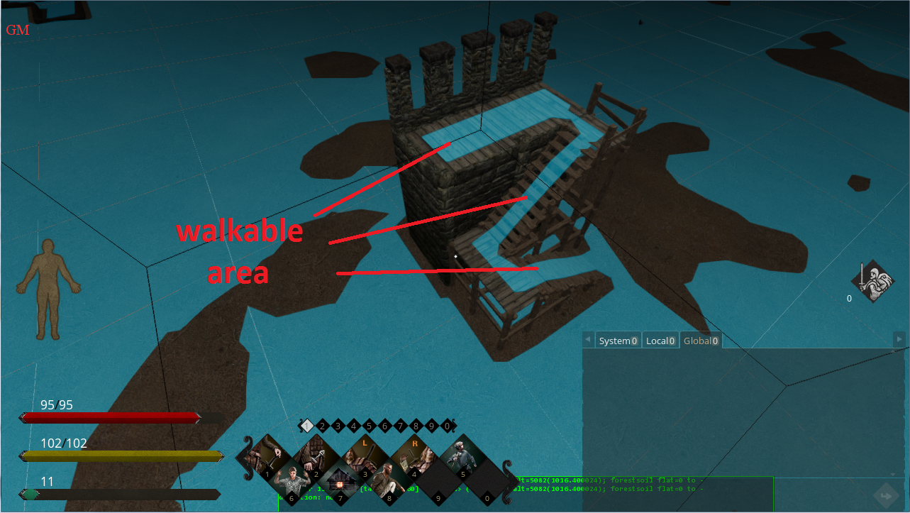

The new pathfinding algorithm removes the old manual implementation, and instead takes advantage of the well-known recast/detour library. This allows us to provide walkable surfaces (Navigation Meshes), not only on the ground, but on the stairs, buildings - everything with proper collision geometry. It’s also fully tunable: maximum angle, impassable area size near walls, etc.

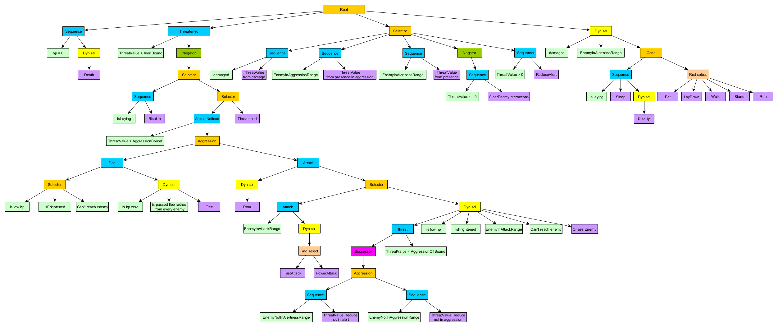

After we had taken care of the new pathfinding, new animals (and the native NPCs in the future) would still be lacking good behavior implementation and proper spawn logic. Therefore, after many discussions, we decided to move forward with the ‘behavior tree’ approach. This technique showed great adjustability and was really clear to understand.
This screenshot shows an approximate behaviour tree for predatory animals, such as bears, boars and wolves.
